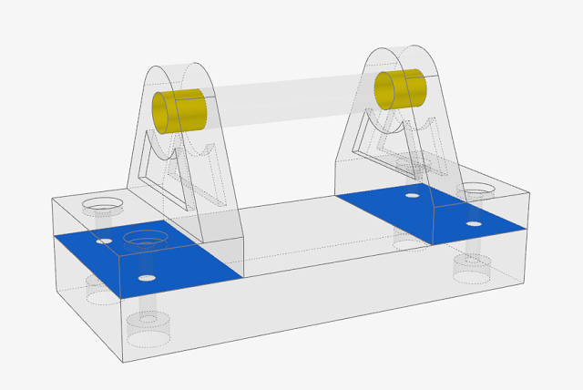

Figure 1. Model with Contacts Defined

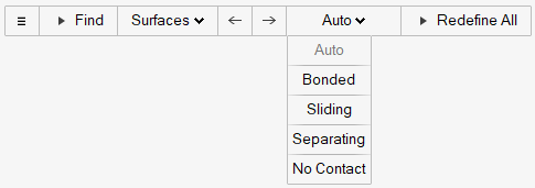

- If Auto is selected on the guide bar, Inspire automatically determines whether contacts should be bonded or sliding based on the presence of other connections between parts. If there are no fasteners or joints connecting two parts together, they are assumed to be bonded. If fasteners or joints are present, parts are assumed to be sliding.

Click a selected contact to open a microdialog and change the type. The options are Bonded, Sliding, Separating, or No Contact.
- Select Bonded if parts are bonded or glued together.
- Select Sliding if there is relative sliding between the parts.
- Select Separating if the relative parts can separate.
- Select No Contact if parts are close but you don't want them to have contact.

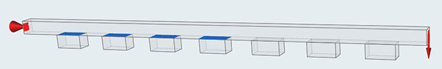

Figure 2. Auto Search Distance
The minimum separation between the beam and the blocks in this model ranges from 0.0 to 0.06 mm. When the search distance is manually set to 0.03 mm, the first four contacts with a minimum separation of 0.03 mm or less are detected.

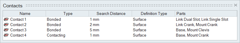

Contacts Table
The Contacts table lists all of the contacts in your model including the type of connection and the parts it connects.
Click the
satellite icon on the Contacts tool to display the table.
The Search Distance listed in the Contacts table shows the minimum gap (the exact minimum
distance between the two parts). The search distance for an individual contact defined in
this table will override the global Auto search distance defined in the Find Options

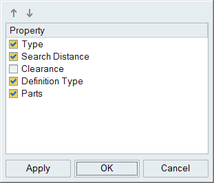

| Add or remove columns | Right-click on a column header. |

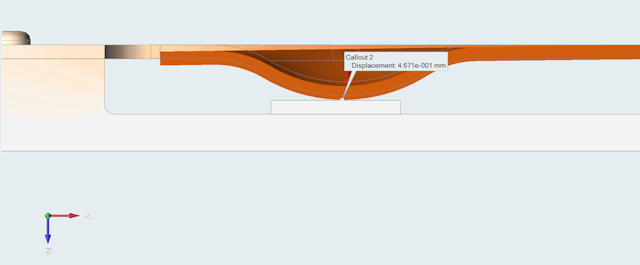

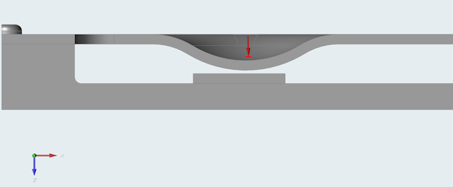

Figure 3. Original Model. There is a 0.5 mm gap between the button and the corresponding contacting part.
Figure 4. No Contact. Deflection is < 0.5 mm, so no contact occurs.
Figure 5. Contact. Deflection is > 0.5 mm, so contact occurs between the parts.

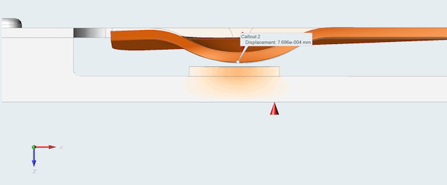

Figure 6. Enforced Contact. Contact is enforced between the parts when clearance is 0.0.
