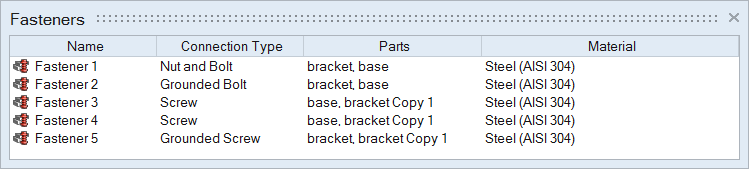

Fasteners Table
The Fasteners table lists all of the fasteners in your model including the type of connection, the parts it connects, and the assigned material.
Click the
satellite icon on the Fasteners tool to display the table.
Figure 1. Fasteners Table
The table data can be edited with the following actions:
| To | Do this |
| Rename a fastener | Select the cell in the table and then click again to make the field editable. |
| Change the connection type or material | Select the cell in the table and then select a different option from the list. |
| Sort a column | Click the column header. Click repeatedly to toggle between ascending and descending order. |
| Add or remove columns | Right-click on a column header. |
