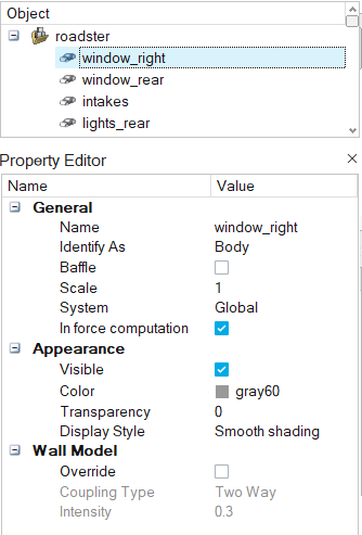

Property Editor
The Property Editor shows all the properties of a selected object and enables you to edit them.
- Click from the menu bar
- Press F3
- Right-click on selected objects and choosing Properties/Hide Properties from the context menu

General
- Name
- Object name. Objects can be renamed in the Model Browser or Property Editor, or by using the right-click context menu.
- Identify As
- Part type in terms of wind tunnel testing: body, heat exchanger in/out/wall, or wheel. This option is also set by means of the Identify Parts tool and the right-click context menu.
- Baffle
- Baffles are two dimensional surfaces that are surrounded by fluid on all sides but do not combine with other surfaces to form a fluid volume. They are used to represent thin regions of solid material that are too costly to explicitly resolve. This option is also set by means of the right-click context menu.
- Scale
- The scale factor of the part with respect to the original geometry that was imported into Virtual Wind Tunnel. This option is also set by means of the Scale tool.
- Group (heat exchanger, wheels)
- Identifies which wheel or heat-exchanger group this part belongs to. You can select different groups from the drop-down list.
Appearance
- Visible
- Indicates whether the selected object is visible (shown or hidden) in the modeling window.
- Color
- Indicates the color assigned to the object when it is displayed in the modeling window.
Click
to create and assign custom
colors. - Transparency
- Transparency of the selected object, according to a percentage. By default, objects are zero percent transparent.
- Display Style
- Indicates how parts and assemblies are displayed in the modeling window. In addition to the default smooth shading display style, each part can be displayed as mesh lines, or as smooth shading with mesh lines.
