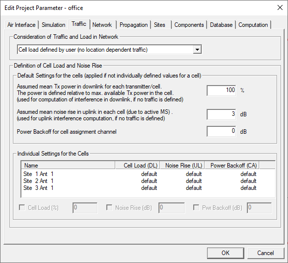

Specifying the Traffic in the Network
Specify the cell load settings that will be used for interference calculations.
Figure 1. The Edit Project Parameters dialog - Traffic tab.
