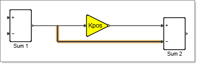

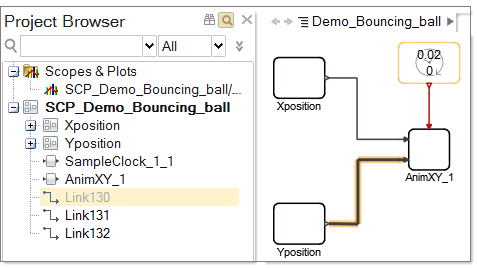

Selecting and Displaying Links
- Link Display
 - The Project
                                Browser includes a filter to show or hide
                        different object types. If the filter is turned on to display links, then
                        every selected link in the block diagram is also selected in the Project Browser. The following
                        figure shows you a model of a bouncing ball diagram with Link 130
                            selected:
