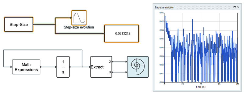

Tip: You can monitor the solver step-size with the SimulatorInfo block found in the Activate > ActivationOperations palette.
