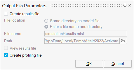

You can generate a .csv profiling file (<modelname>_profile.csv) that contains valuable information for analyzing your simulation. From the ribbon, select Simulation > Output > Create profiling file.
When you run a simulation, in addition to the results file, a profiling file, <modelname>_profile.csv, is generated and stored in the temporary directory (tempdir) for the model.
Note: The tempdir is displayed in the OML Command window when you run a simulation. You can query the location of the directory with the command: GetCurrentModelTempDir.
