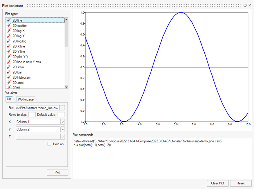

    The Plot Assistant appears with tabs for plotting data from a delimited file, such as a .csv, or your OML workspace. The 2D line plot is generated on startup using data from the demo_line.csv file.
  2. Select the data to plot:
    To Plot from Do this
    Delimited file Select the File tab. Any headers in your file are automatically populated in the list of variables:
    Otherwise, the column number is displayed:
    Options include:
    • Rows to skip: The number of rows from the beginning of the file that dlmread does not read. This is useful when a file contains multiple lines of headers before the numeric data. The Plot Assistant tries to determine the number of rows to skip automatically when a file is selected.
    • Default value: The value to be used in the output for empty or non-numeric values of the input file. If left empty, the value is set to 0.

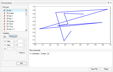

    OML Workspace Select the Workspace tab, then select the desired numerical variables for X, Y and Z.
    If you select a matrix variable, choose the column to plot:
  3. Click the Plot button.
    The plot is created based on your data selections:

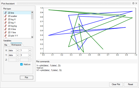

  4. To add a curve to the plot, select Hold on, select a new variable from the workspace or file, then click Plot again.

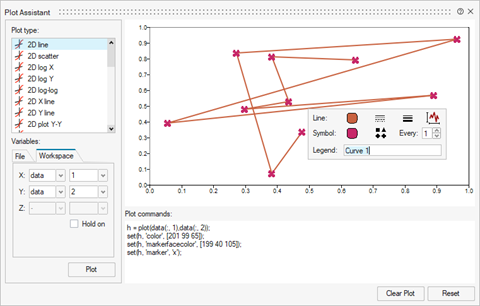

  5. To modify a curve display, right-click the curve and use the options in the microdialog to make your changes.
    When you modify a plot, the Plot Commands window is updated to reflect the changes. For each change you make in a microdialog, a new set command is added at the end of the Plot Commands. If a property has already been changed and has an entry in the Plot Commands, when you make a new change, the previous entry is removed and a new entry is added at the end of the commands.
