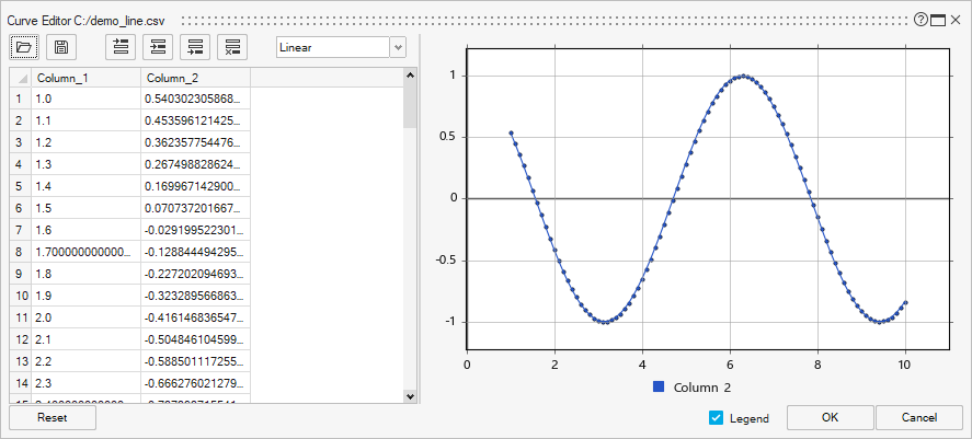

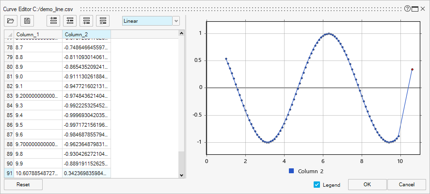

  4. In the Curve Editor dialog, manipulate your curve as follows:
    • Select and drag points to a desired location on the grid.
    • Enter X and Y coordinate values.
    • Select an interpolation method from the drop-down list.
  5. Use the Curve Editor options to further modify and manage your curve data.
