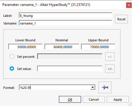

  6. Right-click on the highlighted fields and select Create Parameter from the context menu.
  7. In the Parameter: varname_1 dialog, define the following options and click OK.
    1. In the Label field, enter E_Young.
    2. Change the Lower Bound to 50000.
    3. Change the Nominal value to 60400.
    4. Change the Upper Bound to 70000.
    5. Change the Format to %20.5f.
    Figure 7.

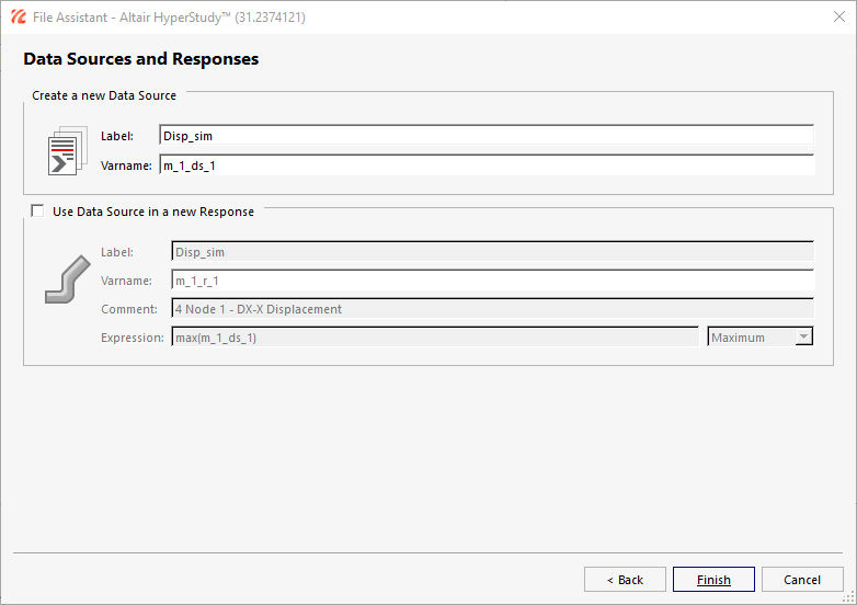

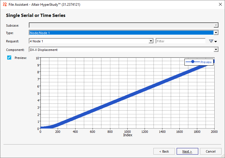

  2. Create a data source labeled Disp_sim.
    1. From the Directory, drag-and-drop the TENSILE_TESTT01 file, located in approaches/setup_1-def/run__00001/m_1, into the work area.
    2. In the File Assistant dialog, set the Reading technology to Altair® HyperWorks® and click Next.
    3. Select Single Item in a Time Series, then click Next.
    4. Define the following options, then click Next.
      • Set Type to Node/Node 1.
      • Set Request to 4 Node 1.
      • Set Component to DX-X Displacement.
      Figure 11.
    5. Under Create a new Data Source, enter Disp_sim in the Label field.
    6. Clear the Use Data Source in a new Response checkbox.
    7. Click Finish.
      Figure 12.
  3. Create a second data source labeled Force_sim by repeating step 2.

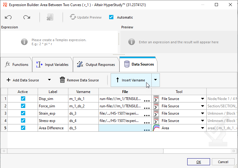

  4. Create a third data source labeled Strain_exp.
    1. In the Expression column of the Area Between Two Curves output response, click .
    2. In the Expression Builder, click the Data Sources tab.
    3. Click Add Data Source.
      A new data source is added to the work area.
    4. In the Label field for the new data source, enter Strain_exp.
    5. In the File field, click .
    6. In the Data Sources Builder, define the data source and click OK.
      • In the File field, navigate to your working directory and open the experiment.xy file.
      • Set Tool to File Source.
      • Set Type to Unknown.
      • Set Request to Block 1.
      • Set Component to Column 1.
  5. Create a fourth file source labeled Stress_exp by repeating step 4.
    Select the following options:
    1. Set Tool to File Source.
    2. Set Type to Unknown.
    3. Set Request to Block 1.
    4. Set Component to Column 2.
  6. Define the Area Between Two Curves output response.
    1. In the Expression Builder, click the Data Sources tab.
    2. Click Add Data Source and choose Area from the Tool options.
    3. In the Label field for the new data source, enter Area Difference.

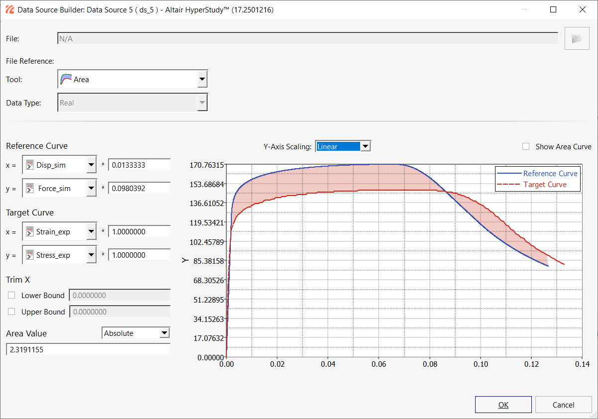

    4. In the File column, click .
      In the Data Source Builder, there are Curve 1 and Curve 2 options for simulation and experimental curve data. Each has x and y data sources entered differently.
      Curve 1_x = Disp_sim
      Curve 1_y = Force_sim
      Curve 2_x = Strain_exp
      Curve 2_y = Stress_exp
      The displacements and forces are read from the simulation, whereas from the experiment you have strains and stresses. In order to convert the displacement and forces to strains and stresses, you need to divide the displacements by the length (75) and forces by the area (10.2). Use the scale factor box to define conversions. For displacement, the scale factor is 175 MathType@MTEF@5@5@+=feaahqart1ev3aaatCvAUfeBSjuyZL2yd9gzLbvyNv2CaerbuLwBLnhiov2DGi1BTfMBaeXatLxBI9gBaerbd9wDYLwzYbItLDharqqtubsr4rNCHbGeaGqiVu0Je9sqqrpepC0xbbL8F4rqqrFfpeea0xe9Lq=Jc9vqaqpepm0xbba9pwe9Q8fs0=yqaqpepae9pg0FirpepeKkFr0xfr=xfr=xb9adbaqaaeGaciGaaiaabeqaamaabaabaaGcbaWaaSaaaeaacaaIXaaabaGaaG4naiaaiwdaaaaaaa@383E@. For the area, the scale factor is 110.2 MathType@MTEF@5@5@+=feaahqart1ev3aaatCvAUfeBSjuyZL2yd9gzLbvyNv2CaerbuLwBLnhiov2DGi1BTfMBaeXatLxBI9gBaerbd9wDYLwzYbItLDharqqtubsr4rNCHbGeaGqiVu0Je9sqqrpepC0xbbL8F4rqqrFfpeea0xe9Lq=Jc9vqaqpepm0xbba9pwe9Q8fs0=yqaqpepae9pg0FirpepeKkFr0xfr=xfr=xb9adbaqaaeGaciGaaiaabeqaamaabaabaaGcbaWaaSaaaeaacaaIXaaabaGaaGymaiaaicdacaGGUaGaaGOmaaaaaaa@39A1@.
      Figure 13.
    5. For Curve 1, enter 0.0133333 in the scale factor box for x as shown in Figure 13.
    6. For Curve 1, enter 0.0980392 in the scale factor box for y as shown in Figure 13.
    7. Click OK to close the Data Source Builder.
  7. In the Expression Builder, click Insert Variable.
    Figure 14.
  8. Click OK to close the Expression Builder.
  9. Click Evaluate to extract the response values.

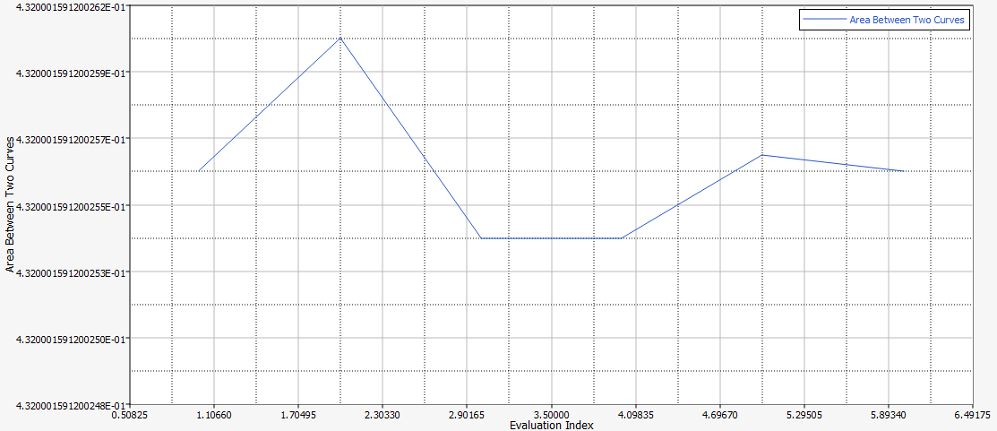

  8. Go to the Evaluate step.
  9. Click Evaluate Tasks.
  10. Click the Evaluation Plot tab to plot the optimization iteration history of the objective.
    Figure 16.
