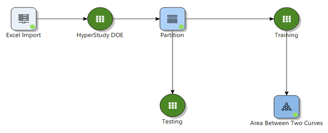

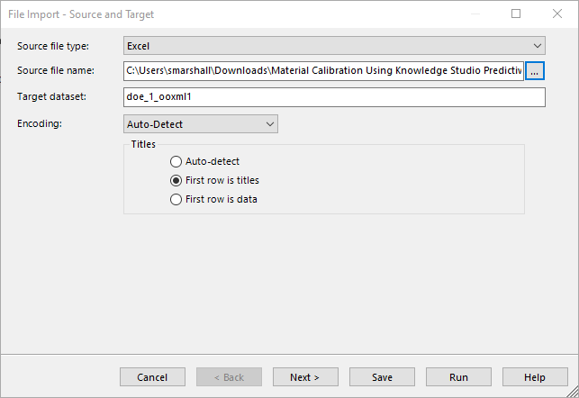

  1. Import doe_1_ooxml.xlsx into Knowledge Studio.
  2. Build a machine learning model of your preference. In this tutorial, Deep Learning model is selected.
  3. Verify high accuracy is achieved.
    If high accuracy cannot be obtained, it may be due to insufficient data. Therefore, another DOE is needed to compensate. Cross-validation, R2, of Deep Learning model is 0.975598.

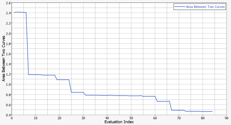

  11. Go to the Evaluate step.
  12. Click Evaluate Tasks.
  13. Click the Evaluation Plot tab to plot the optimization iteration history of the objective.
