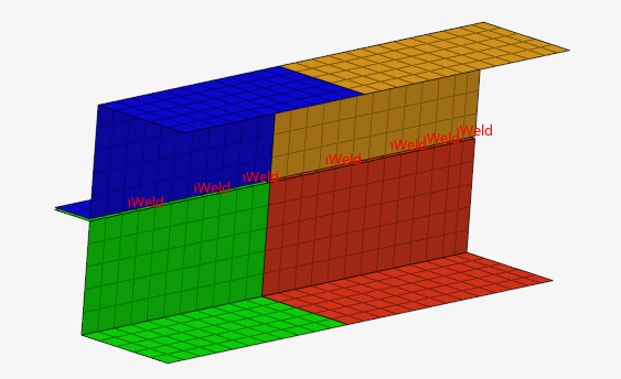

  5. Open model.
    1. From the menu bar, click File > Open > HyperMesh Model.
    2. In the Open Model dialog, open the boxbeam_morphed_noDV.hm file.
    A model appears in the graphics area.

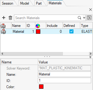

  6. Create and assign parameter to Material.
    1. In the Model Browser, Material folder, double-click Material.
      The Material browser opens.
    2. In the Material browser, select the Material.
      The Entity Editor opens and displays the material's corresponding data.

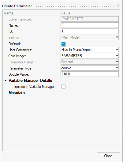

    3. In the Entity Editor, right-click on E and select Parameter > Create from the context menu.
      Figure 3.
      The Create Parameter dialog opens.
    4. In the Name field, enter E.
    5. Click Close.
      Figure 4.

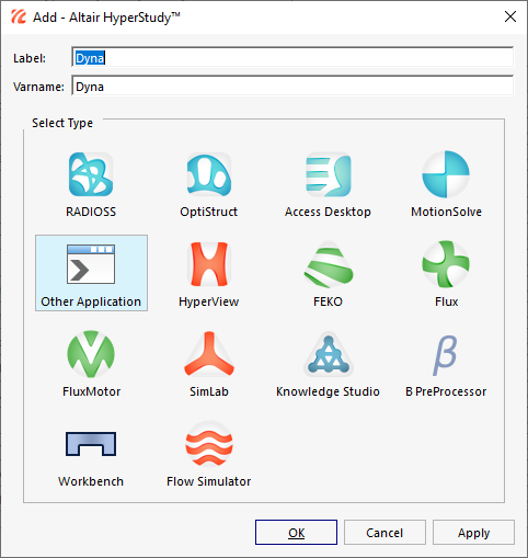

  3. Add solver script.
    1. Click Add Solver Script.
      The Add dialog opens.
    2. In the Label and Varname fields, enter Dyna.
    3. From the list of solver script types, select Other Application.
    4. Click OK.
    Figure 5.

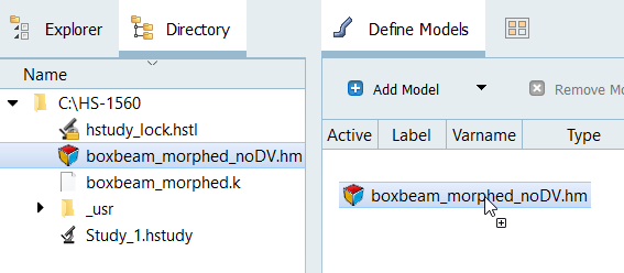

  4. Add HyperMesh model.
    1. From the Directory, drag-and-drop the boxbeam_morphed_noDV.hm file into the work area.
      Figure 6.
    2. In the Solver Input File column, enter boxbeam_morphed.k.
      This is the name of the solver input file HyperStudy writes during any evaluation.
    3. In the Solver Execution Script column, select Dyna (Dyna).
    4. In the Solver Input Arguments column, enter i= before $file.
    Figure 7.

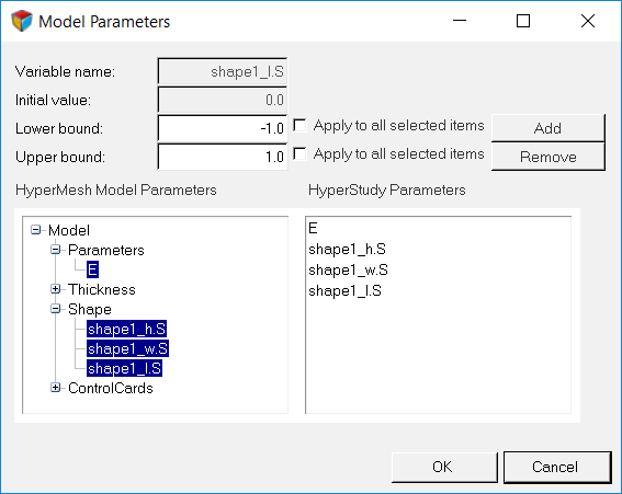

  5. Import variables.
    1. Click Import Variables.
      The Model Parameters dialog opens.
    2. Select the parameters E, shape1_h.S, shape1_w.S, and shape1_l.S.
    3. Click Add.
    4. Click OK.
    Figure 8.

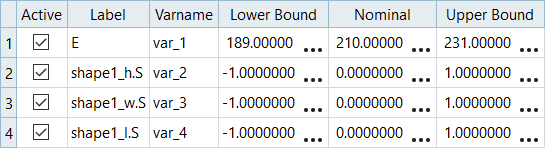

  6. Go to the Define Input Variables step.
  7. Review the input variable's lower and upper bound ranges.
    Figure 9.

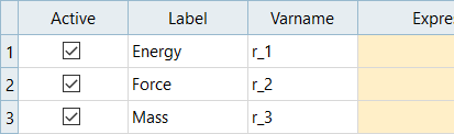

  2. Click Add Output Response three times to add three output responses labeled Energy, Force, and Mass.
    Figure 10.

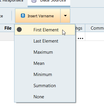

    11. Next to Insert Varname, click and select First Element.
      Figure 12.
    12. Click Insert Varname.
