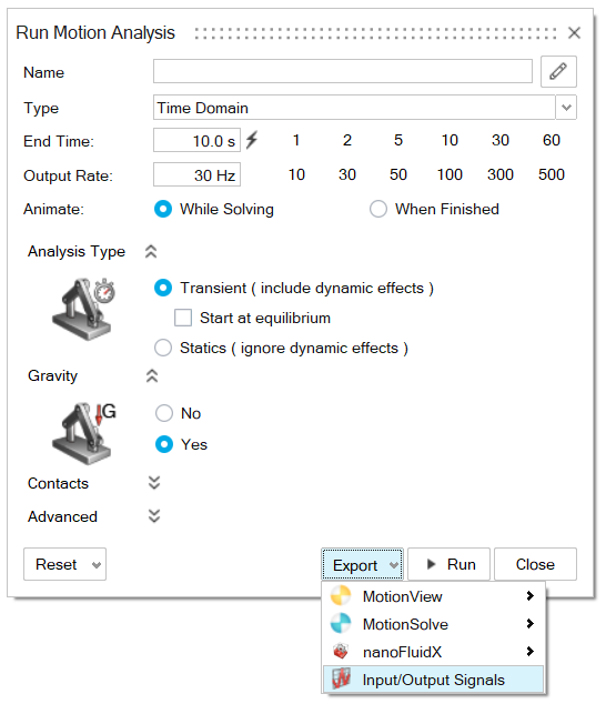

Export motion analysis results using the Export button on the Run Motion Analysis window.

- In the Run Motion Analysis window, select , and then select a unit system.
- Select , enter a file name, and then select Save.

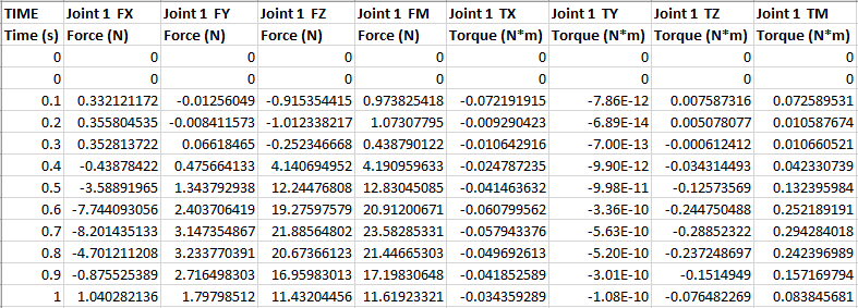

- If you make a change to the model that requires running a reanalysis, the check icon disappears, and you will not be able to export plot data until you run another motion analysis.
- Plot settings on the Run Motion Analysis window must be set to All and
Global in order to export loads on parts. Otherwise the Export Loads option
is disabled in the plot context menu for the chart. Below is an example of a sample .csv file.
