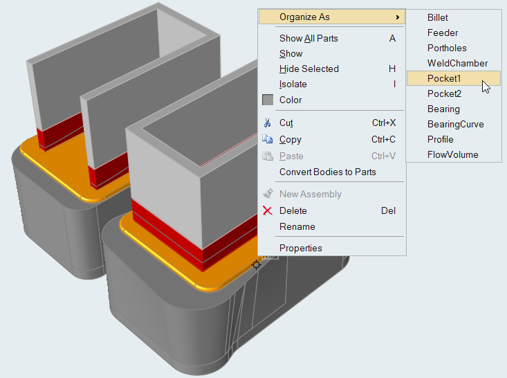

The flow volume solid is cut either manually or by using the Organize Table. The various components are assigned a name according to their properties (name is essentially an alias for the collector).
The size of the mesh (corresponding to each component of the flow volume) is assigned on the basis of the collector name, internally.
It is very important to properly assign the name to a component as the results might deviate if there is improper assignment. For example, the mesh for the billet is always coarser than the mesh done in pocket, so assigning a billet collector to a pocket component might give very different results or meshing can even fail.

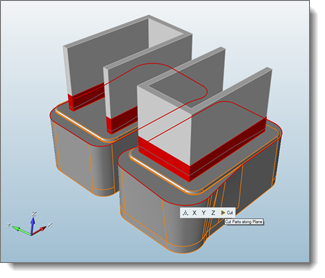

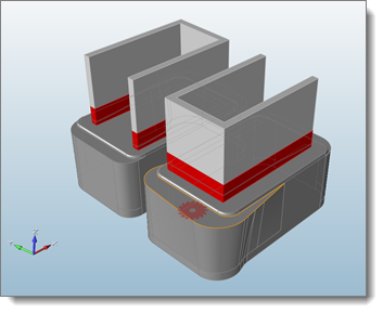

There are two ways of organizing solids. The first is to use the Organize Table feature. The second is to cut the flow volume manually and then assign the names.
Organizing Volumes using the Organize Table
Use the Organize Table to organize the flow volume solids.
Before using the table, know the length of each of the components to organize as respective collectors. The Organize Table works on the solid characterized as flow volume only. If there are multiple flow volumes, combine them into one flow volume.
Organizing Volumes Manually
Volumes can be organized manually by entering the values in the dialog. This can be useful if you don't know the length of the components.
