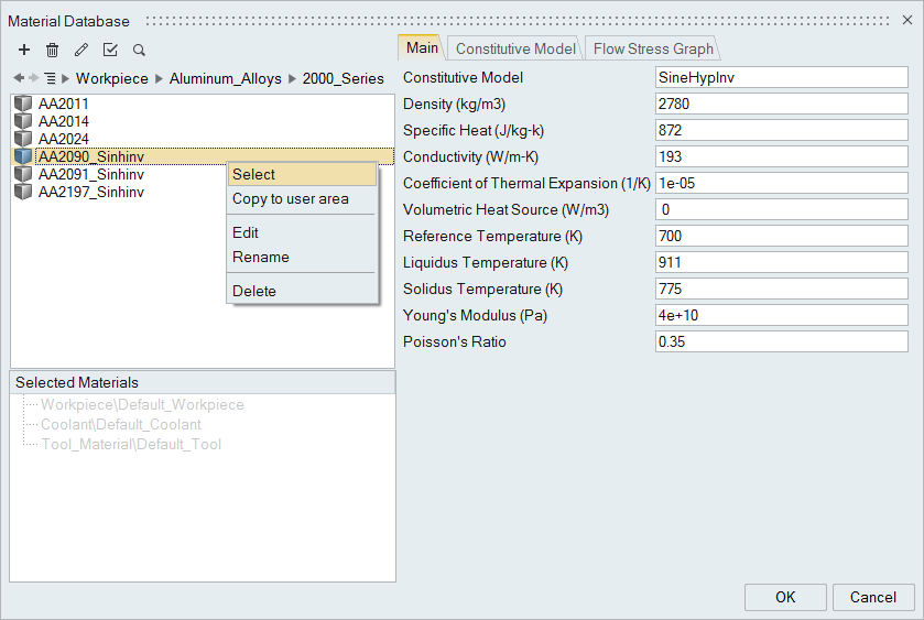

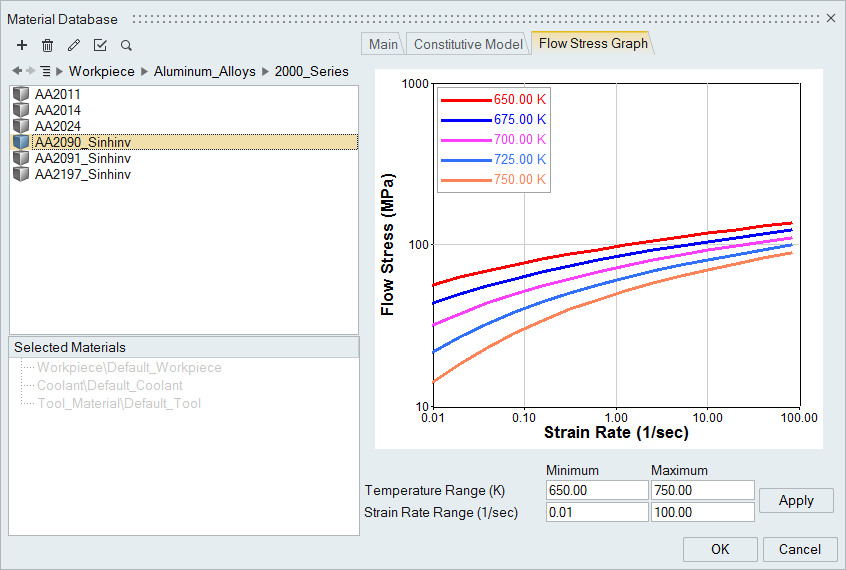

Selecting Materials
Use the Materials tool to select materials for the analysis.

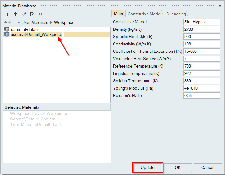

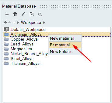

Fitting Materials
Use the Materials tool to fit materials.
Name = SampleWorkpieceMat1
Class = Workpiece
Density = 2705
SpecificHeat = 900
Conductivity = 231
CoeffOfThermalExpansion = 1e-005
VolumetricHeatSource = 0.0
ReferenceTemperature = 700
LiquidusTemperature = 930
SolidusTemperature = 919
YoungModulus = 4.0e+10
PoissionRatio = 0.35
END HEADER DATA
MaxIterations = 21
ExtrudabilityNumber = 200
PrintTable 1
END

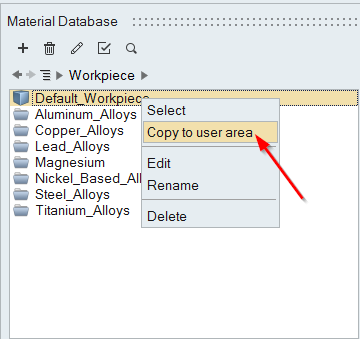

Copying Materials
Use the Materials tool to copy materials.
