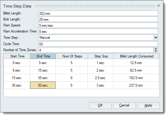

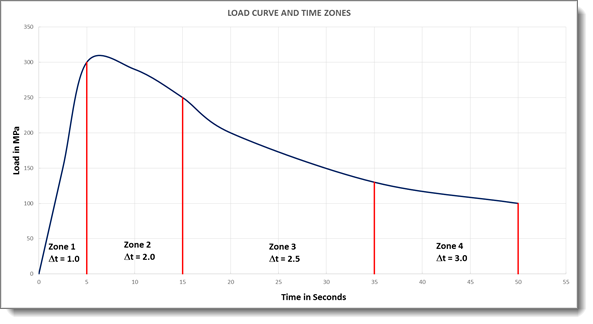

Defining the Variable Time Step Manually
The Manual option in the Time Step Data dialog is used to control and change the time step for a transient problem. This allows you to define up to five different time step sizes during the cycle (referred to as zones).
Inspire Extrude automatically estimates the cycle time. You can reduce this cycle time to solve for less than full cycle analysis.

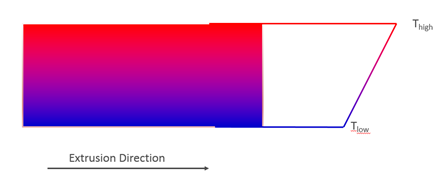

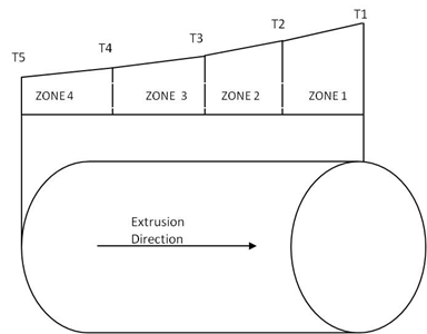

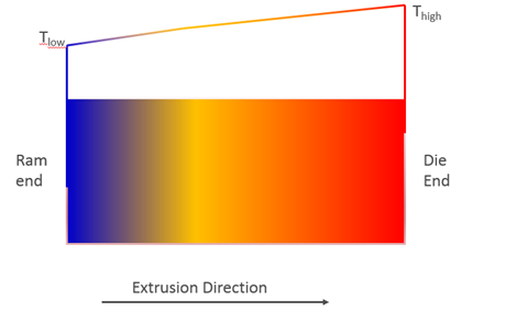

Setting Up the Billet Taper
- Axial taper
- Lateral taper
- Radial taper
Billet Taper Examples

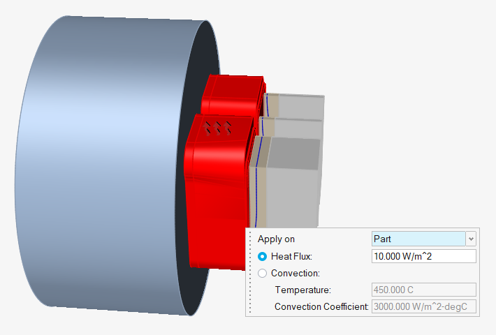

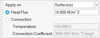

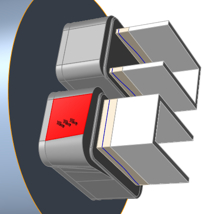

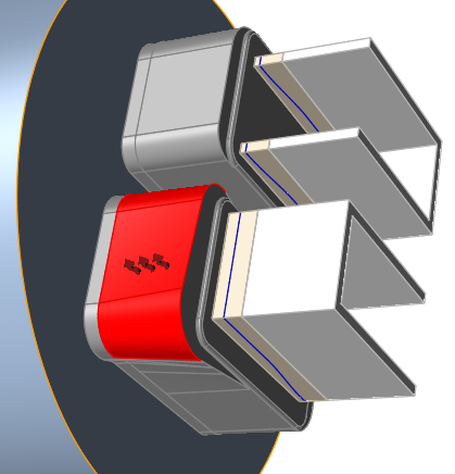

Defining Heat Transfer Coefficient
Select faces to specify heat transfer boundary conditions.
