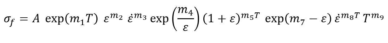

Hensel Spittel Model

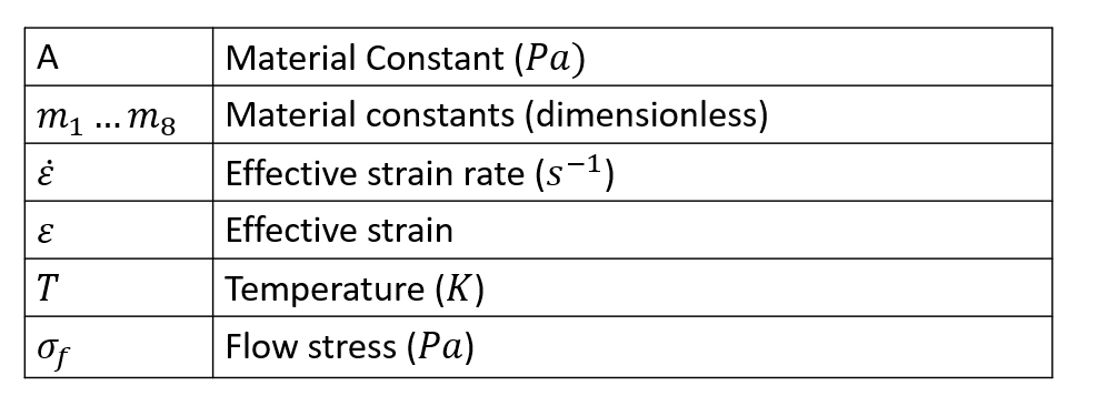

Temperature, strain, and strain rate dependent Hensel Spittel model used in HyperXtrude is given by the following expression. It has a built-in temperature dependence in the equation and it is used all the time.
