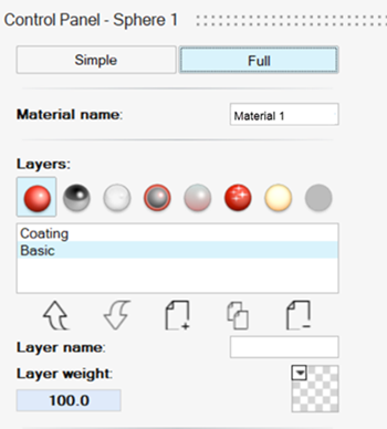

You can layer materials with a high degree of control over each layer.
The area below the Material name lists the layers in the selected material. When you select a layer from the list, the corresponding layer type (Basic, Metal, etc.) is highlighted.

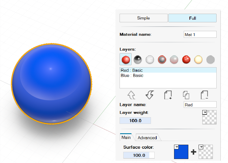

In the example below, there are two basic layers named Red and Blue.
Weight
Layer weight influences the material from top to bottom. If the topmost layer has a weight of 100%, then any layer underneath will not be considered by the engine.

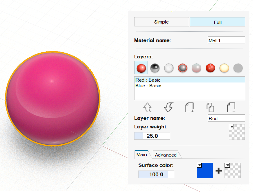

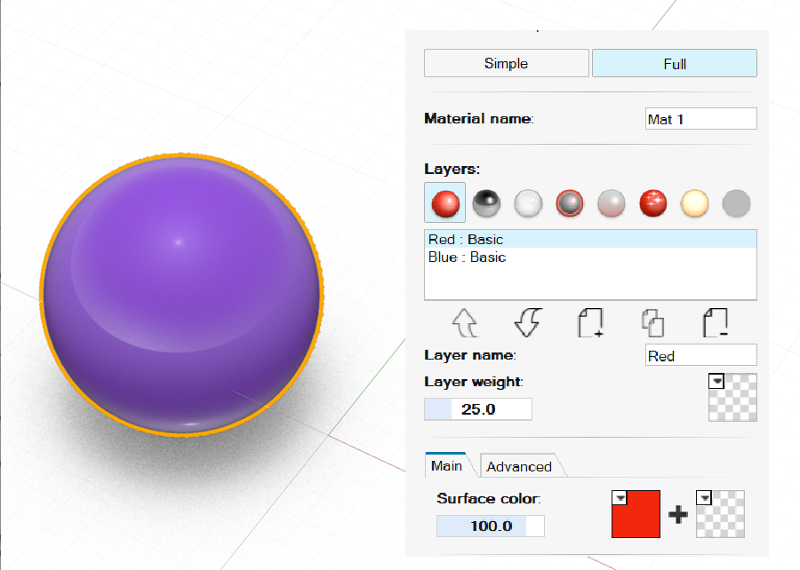

All layers are normalized according to their sum, so that each layer's reflectance is modified by a relative percentage. Without any weights, the layers are again normalized to reflect the same weights.
The weight of the coating layer modifies the percentage of light allowed to penetrate the layers underneath.
Stacking Order
Figure 1. Blue on top of Red; Blue weight = 25%, Red weight =
100% |
Figure 2. Red on top of Blue; Red weight = 25%, Blue weight =
100% |
