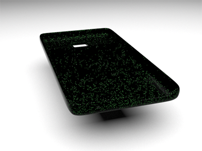

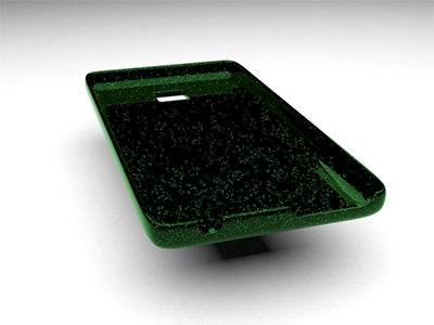

To define the shade, enter a value of 0-100, where 100 is the true color and 0 is black.
Figure 1. Satin Black Plastic from the Material Library - Glow Color
- Define the color of the glow.
- Glow Intensity
- Define how intensely the metallic flakes glow. Increase this value for a brighter glow; decrease it for a softer glow. We suggest keeping this value under 30-35%, as increasing this number too much can obliterate the base color.
