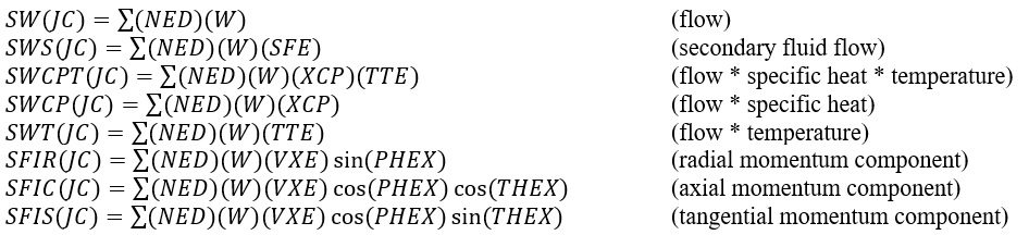

Recalculating the Chamber State
Fluid state in each chamber, with the exception of boundary chambers, is recalculated for each iteration as the solution progresses. The total and static pressure in the non-boundary chambers are the independent parameters varied by Flow Simulator to balance the flows in the circuit. The remaining chamber variables, other than those specified as fixed by some other input to the model, are dependent variables. To calculate the dependent chamber variables Flow Simulator employs the data of all the element flows entering the chamber.
For each element flow the following data is known,
W: Element flow rate
SFE: Secondary fluid mass fraction in element flow
JC: Downstream chamber number
NED: Number of element flows entering downstream chamber
TTE: Total temperature relative to the chamber rotational speed
XCP: Specific heat
PHEX: Radial flow angle relative to the chamber
THEX: Tangential flow angle relative to the chamber
VXE: Magnitude of flow velocity relative to the chamber rotational speed
(The value for XCP is obtained from the properties subroutine using TTE, SFE and the static pressure in the chamber (PSC))
The above data for each element with flow entering chamber is summed to give the following total values:

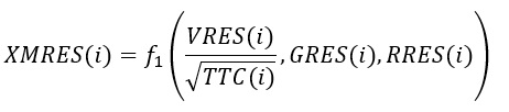

The resultant Mach number is computed from Mach
number routine using TTC, GRES, RRES and VRES.
For inertial chambers, XMRES is not limited in magnitude and may be greater than 1.0 if VRES is sufficiently large. For momentum chambers, the GENDAT input variable ISUPER determines whether XMRES is permitted to be supersonic. The default value of ISUPER = 0 limits the maximum value of XMRES for momentum chambers to 1.0. The chamber XK (swirl ratio) is not a primary chamber variable but it is calculated in the same routine as the rest of the chamber data so will be described here. The calculated XK’s are calculated and reported with respect to the absolute reference frame for all chamber types. The XK calculation does depend on the chamber type, however. The XK of a plenum chamber should always be 0 or 1 since a plenum chamber is rotating with its attached elements and the through flow velocity from the attached elements is dissipated. The XK for a momentum chamber is based on the velocity in the chamber, VRES, the flow angles, θ and ϕ and the chamber rotation. The XK for an inertial chamber is based on the velocity in the chamber, VRES, the flow angles θ and ϕ. If the inertial chamber is associated with a cavity, the calculated cavity XK is used to set the chambers tangential velocity by recalculating SFIS.
