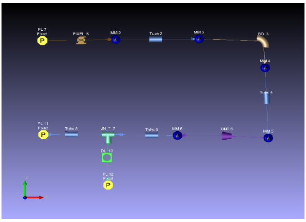

A out-of-network chamber type, known as vortex-type chamber, for the modelling of vortexes and cavities. A sample network illustrating some of the features in schematic form is displayed in Figure 1.
Figure: Sample Flow Network Flow Simulator model
A Flow Simulator model consists of a network of chambers and elements with defined fluid pressure, temperature, velocity, flow direction, and mixture fraction at the boundary chambers. The flow resistance characteristics of each element are defined in the model. Initial guess values for the pressures, temperatures and velocities are prescribed at the internal chambers. To complete the input, a set of general data is included, which specifies output file requirements, convergence tolerances, and solution control parameters.
