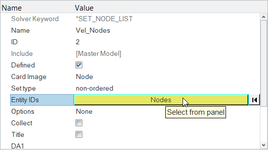

Create a Node Set
In this step, you will create a node set, *SET_NODE_LIST, which will contain all of the nodes in the head component of the model.

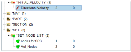

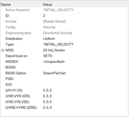

Define the Velocity
In this step, you will define the velocity for the model.

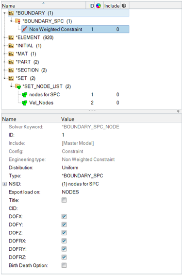

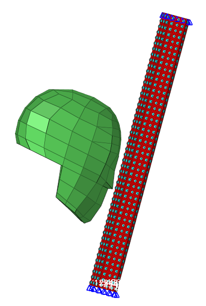

Create Constraints on the Pillar's End Nodes
In this step, you will create constraints on the ends of the pillar component of the model.

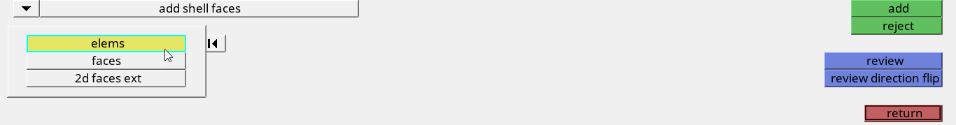

Define a *SET_SEGMENT for the Secondary Entities
In this step, you will create a new contactsurf on the pillar element of the model.
Define a *SET_SEGMENT for the Main Entities
In this step, you will create a contactsurf on the head component of the model.
