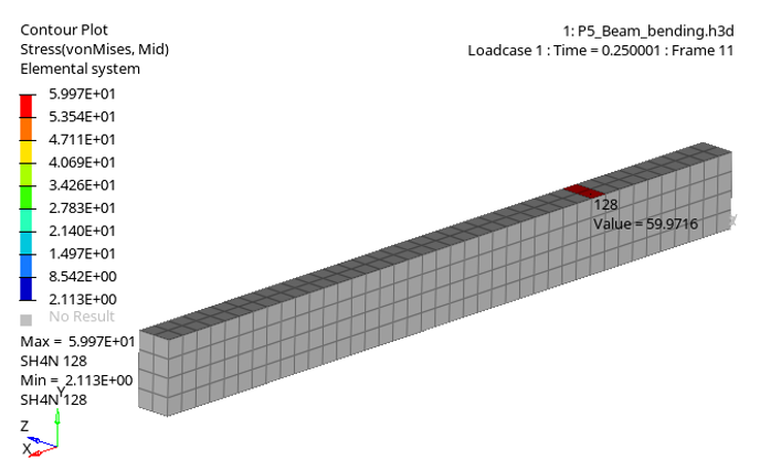

A beam with dimensions length = 508 mm, height = 50.8 mm, and width = 25.4 mm is meshed using solid elements that are length and width of 12.7 mm. Steel material properties are used with a Poisson’s ratio of zero to eliminate artificial stiffening. A uniform pressure of 0.3447 MPa is applied across the top of the beam. The pressure is applied using a smooth function to minimize the vibration of the beam during loading. The pressure is applied from 0.0 – 0.15 s and then held until 0.25 s. To measure the stress at the top of the beam, two shell elements are placed 120.65 mm from the fixed end of the beam.

Figure 3. Beam Bending von Mises Stress
The calculated displacement at the center of the end of the beam was 1.3713 mm compared to the analytical result of 1.3752 mm. This results in a numerical error of 0.28%.
The calculated stress in the shell elements on the top of the beam was 59.9716 MPa compared to the analytical result of 58.5562 MPa. 1 This results in a numerical error of 2.42%.
