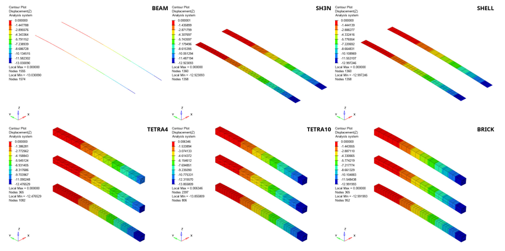

In this example, different mesh techniques are compared: beams, 3 and 4 noded shells, hexahedral elements and tetrahedral (tetra4 and tetra10) elements, as well as different element sizes.
The results are extracted and compared between each other with respect to their mesh size and element formulation. As output, the maximum vertical deflection, number of cycles, calculation time, element stress, and overall error are used. The maximum vertical deflection is compared to the theoretical value.

Element | Mesh Size [mm] | Element Formulation | Maximum Deflection in Z-Direction [mm] | CPU Cost Factor (vs QEPH Shells) | Total Number of Cycles | Difference to Theoretical value [%] |
BEAM | 10 | BEAMN3 | 13.03 | 1.3 | 255801 | 0.3 |
5 | 13.03 | 0.3 | ||||
SH3N | 10 | Ish3n=0,2 | 12.919 | 1.7 | 245758 | 1.2 |
5 | 12.981 | 0.7 | ||||
SH3N | 10 | Ish3n=30 | 12.903 | 3.3 | 450006 | 1.3 |
5 | 12.923 | 1.1 | ||||
QBAT | 10 | Ishell = 12 BATOZ |
12.885 | 1.7 | 139698 | 1.4 |
5 | 12.946 | 0.9 | ||||
QEPH | 10 | Ishell = 24 QEPH |
12.975 | 1.0 | 137169 | 0.7 |
5 | 12.997 | 0.6 |
