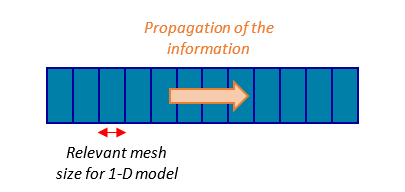

Each section is modeled by one component.
Both are meshed with 3D /BRICK elements. As the problem is
one-dimensional, the relevant mesh size is the width of the mesh in the direction of
interest (here, the direction of propagation of the compression and rarefaction
waves). The size of the mesh in the other directions is of no importance (Figure 3). Figure 3. Relevant Mesh Size for 1D Model
The model is meshed with 512 elements (which accounts for a mesh size in the
direction of interest of roughly 2 mm). Figure 4. Mesh Used for the 1D Shock Tube

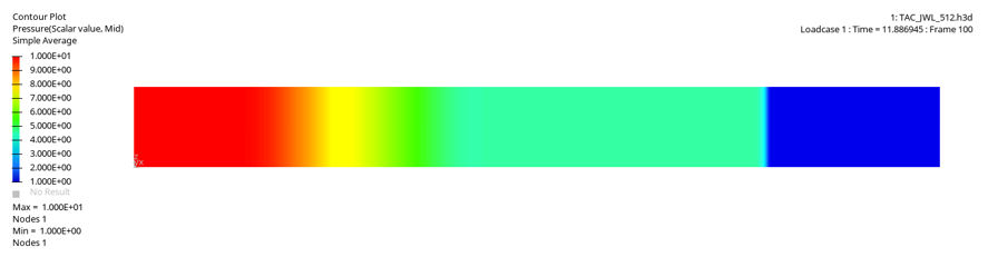

Results
Results are examined 12 s
after the removal of the separation between the two chambers.
Figure 6. Pressure Contour after 12s

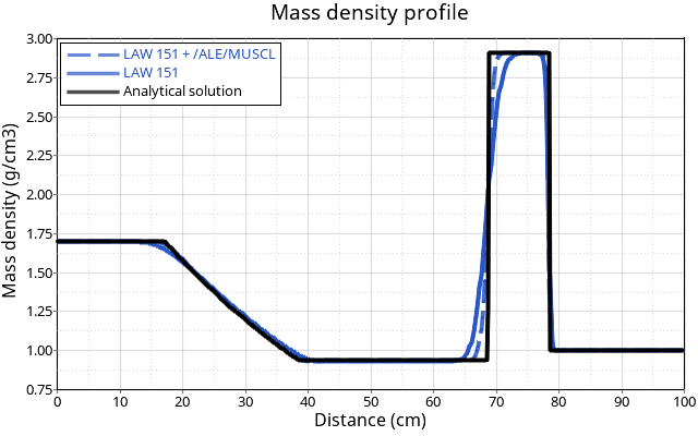

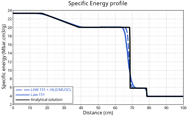

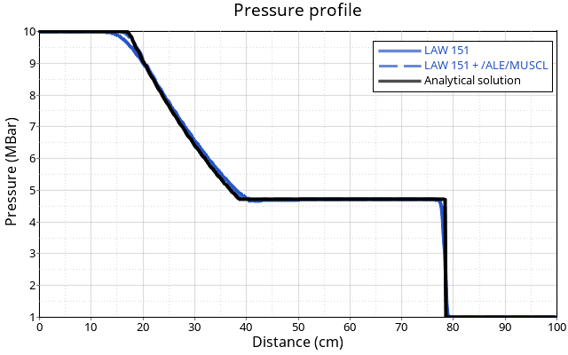

Profiles of pressure and mass density along the tube after 12 s are visible on
Figure 7 and Figure 8, as well as similar profiles for velocity and
specific energy on Figure 9 and Figure 10, with the
curve obtained from the analytical solution.Figure 7. Pressure Profile. (with and without /ALE/MUSCL, compared to analytical
solution) Figure 8. Mass Density Profile. (with and without /ALE/MUSCL, compared to analytical
solution) Figure 9. Velocity Profile. (with and without /ALE/MUSCL, compared to analytical
solution) Figure 10. Specific Energy Profile. (with and without /ALE/MUSCL, compared to analytical
solution)
The simulation results for these four variables matches closely the analytical
solution, and the fit is better for the results obtained with
/ALE/MUSCL enabled.
