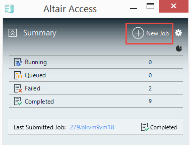

Double-click the Access Desktop icon from the system tray.
The Access Desktop application is displayed.
Click New Job.
Figure: Submit a New Job
A list of solvers and saved profiles is displayed.
Choose a solver or a saved profile from the list by double-clicking it.

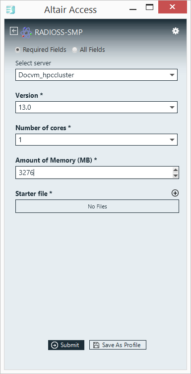

A job submission form is displayed containing the required solver
arguments.
Tip: To display all available solver arguments, click
All Fields.
Figure: Job Submission Form Example
Fill in any required solver arguments.
To reuse the values you entered, click Save as Profile.
The next time you choose Process With from the context menu, the
saved profile is displayed.
