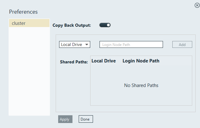

  1. Open the Windows system tray.
  2. Double-click the Access Desktop icon .
  3. Click .
  4. Select Preferences from the menu.
    A preferences menu is displayed.
    Figure: Preferences
  5. Select the cluster from the list that is displayed in the left to map the shared network path.
  6. Select the mapped drive from the Local Drive list.
  7. Enter the Linux shared file system path in Login Node Path.
    An example of the Linux shared file system path is: /hwesuse110-14/samba/share
  8. Click Add.
  9. Click Apply.
  10. Click Done to close the preferences menu.

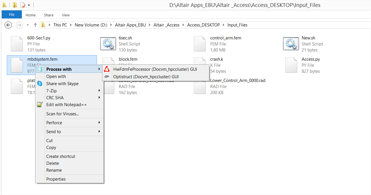

  1. Open your mapped network drive in Windows Explorer.
  2. Select the project folder in the shared file system.
  3. Right-click the job input file.
  4. From the context menu, select Process With.
    A list of solvers and saved job profiles along with the server name specific to the file type of the job input file are displayed.
    Figure: Solvers and Job Profiles Specific to the Job Input File Type
  5. Select a solver or job profile.
    If additional information is necessary to submit the job, then a job submission form is displayed containing the required solver arguments. Otherwise, the job is submitted.
