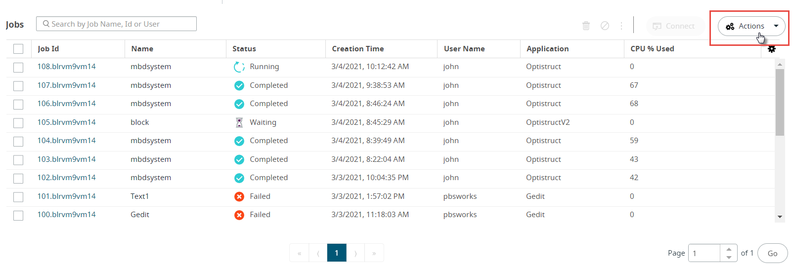

  1. Click the Jobs tab located in the upper left-hand of the page.
    The Job Monitoring view is displayed containing a list of the jobs that have been submitted.

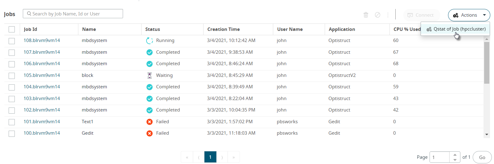

  2. Select a job from the list and click Actions.
    Figure: Job Action
  3. Click Qstat of Job from the list.
    Figure: Job Action List

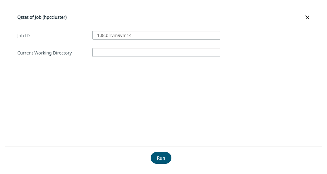

    Action Menu Input Dialog Box is displayed with the output directory of the job that is selected.
    Note: The Action Menu Input Dialog Box will not be displayed if the generic action script does not require any input from the user. The generic action will be performed on the job and the output will be displayed.
    Note: If you had selected multiple jobs, then the output directory will be blank.
    Figure: Action Menu Input Dialog Box
  4. Enter the working directory.
  5. Click Run

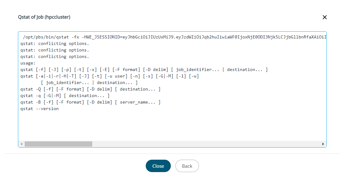

    The action list performed on the Job will be displayed.
    Figure: Job Action Display
