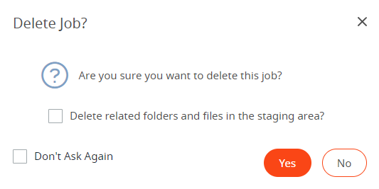

    The Delete Job dialog box is displayed.
    Figure: Delete Job
  4. Perform one of the following options:
    • Click Yes to remove the job.
    • Select Delete related folders and files in the staging area? check box and click Yes to remove the job from the staging area.
