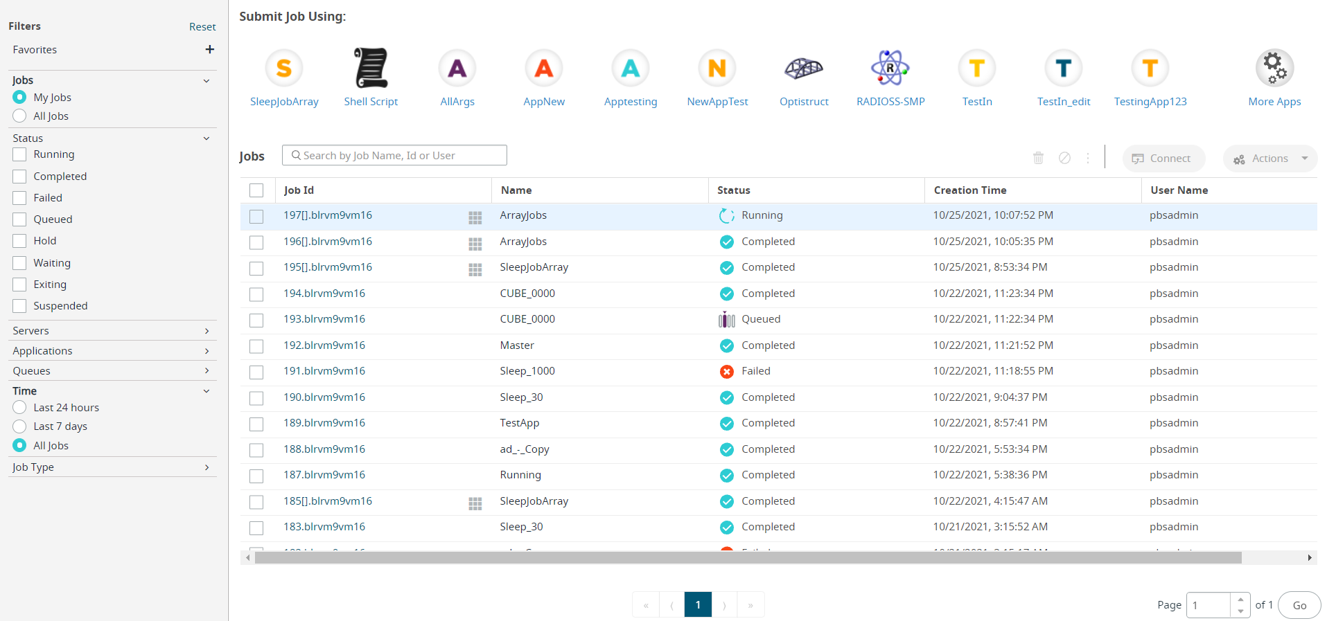

  1. Click the Jobs tab located in the upper left-hand of the page.
    The job monitoring page is displayed with the list of the jobs that is submitted to a cluster.
    Figure: Job Monitoring View
    Note: Job arrays are indicated with "[]" braces with the Job ID and it is also indicated with the icon in the Job ID column.

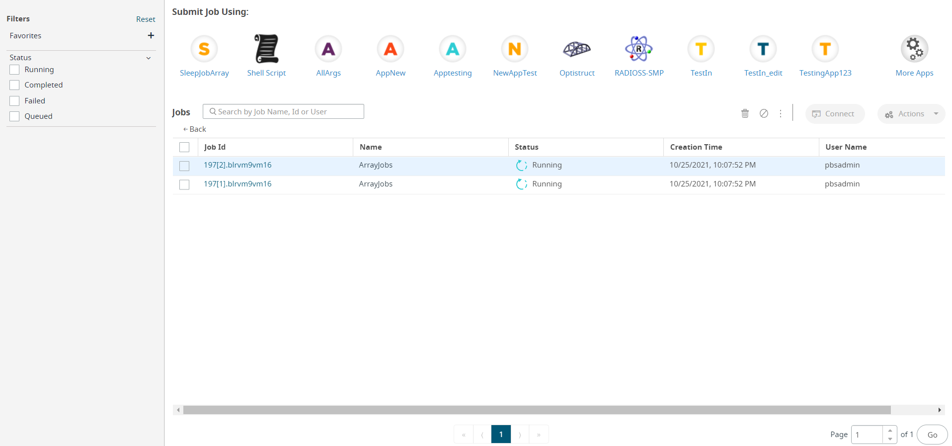

  2. Click on one of the job array.
    Figure: Job Array Summary
    The left panel provides the Filter option to refine the sub jobs that is displayed. This allows you to display the sub jobs monitoring results such as Running, Completed, Failed, and Queued. You can also save the filter option as Favorites.
    Note: The sub jobs displayed can be refined using the Filter option. You can also save the filter option as Favorites that you have used.

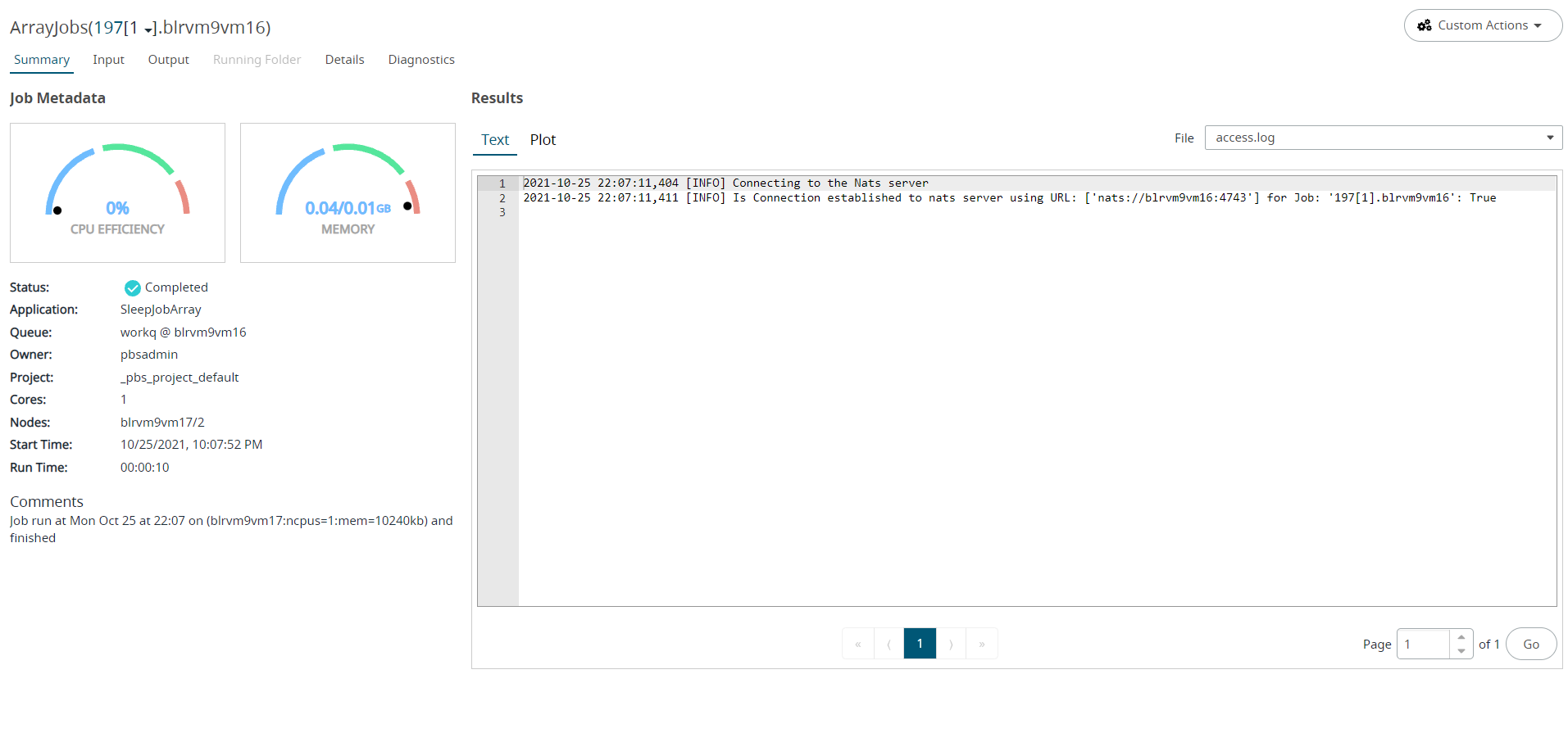

    The sub job of the batch job is displayed.
    Figure: Sub Jobs Details
    Tip: You can use the drop-down option located next to the Jobs name and select a particular subjob to view its details.
