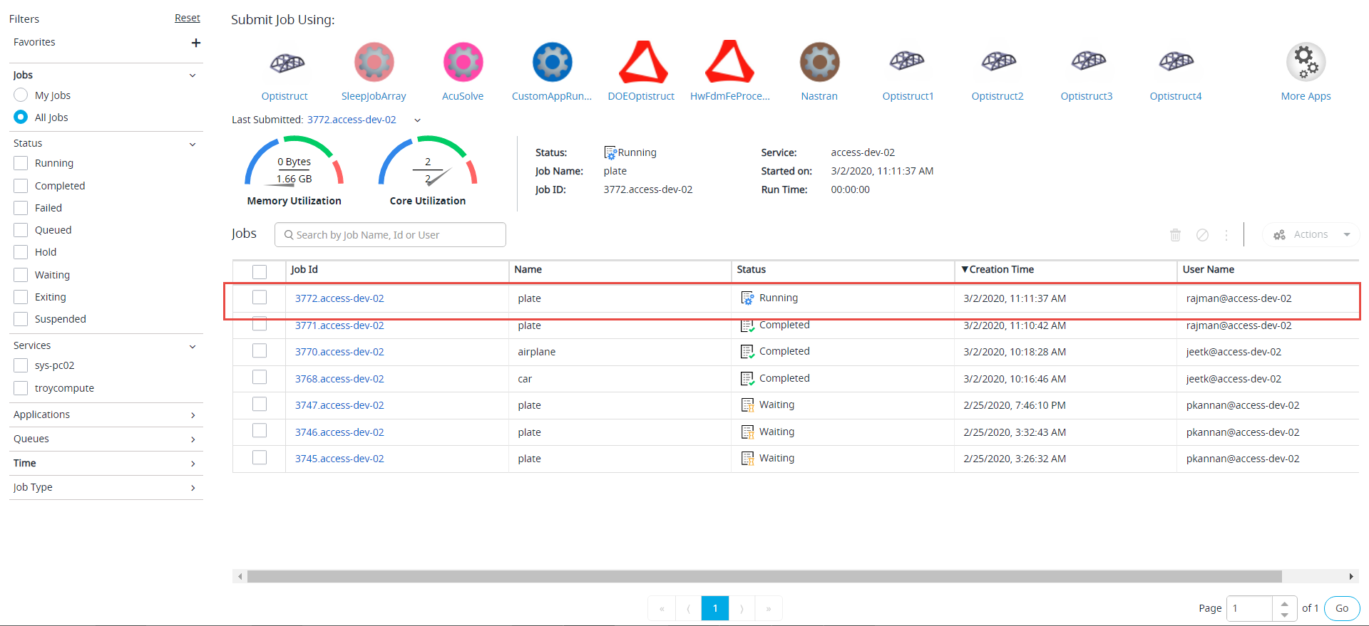

  1. Submit a job to the server. In this example, a Optistruct job (3772.access-dev-02) is submitted to troycompute server.
    When you view all the jobs, the Optistruct job (3772.access-dev-02) is listed in the Job Monitoring page.
    Figure: Job Monitoring

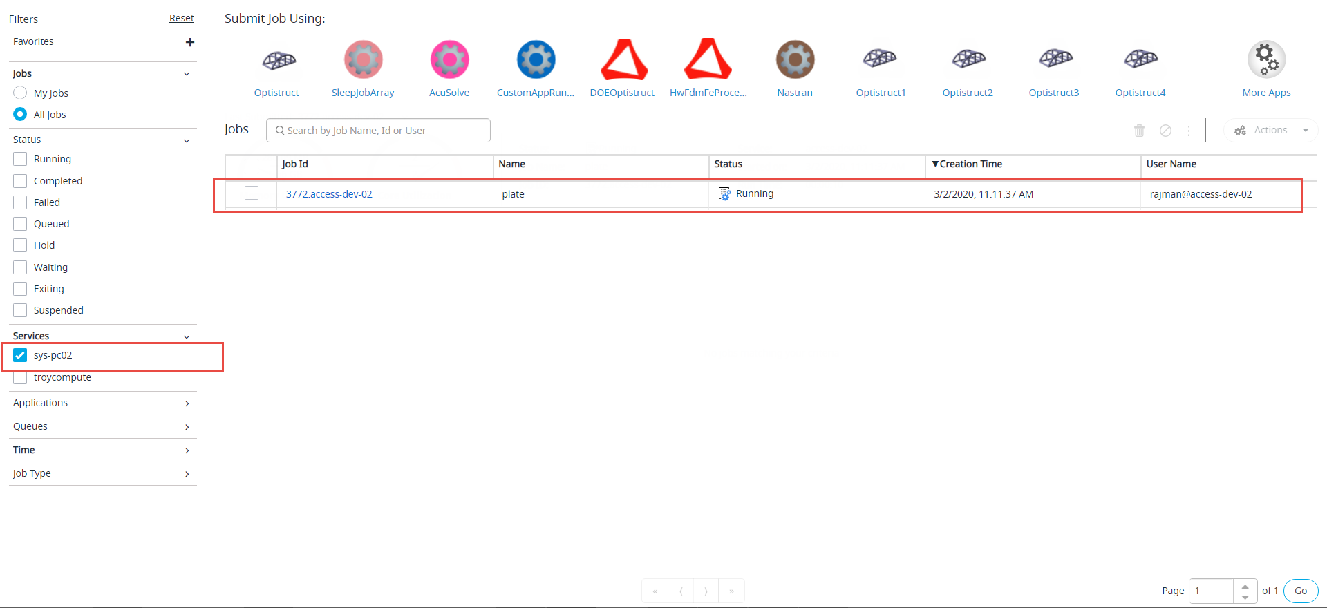

  3. Change the Server filter to view the jobs in sys-pc02 server.
    The Optistruct job (3772.access-dev-02) will be listed in the Job Monitoring page as it is moved from troycompute to sys-pc02 server.
    Figure: Jobs in syspc02compute Server
