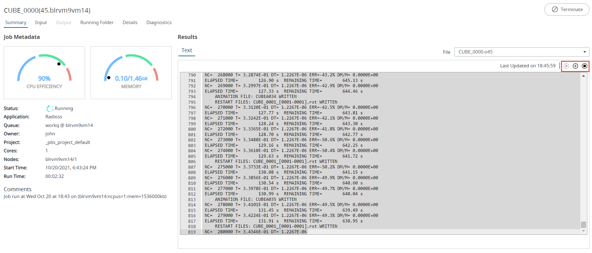

    Figure: Job Summary Tab
    From the files list you can select a file to view its content in the Text, Plot or Image viewers. You can monitor the progress of the job by viewing the updated contents of the selected file. You can visualize plots and animations from result files for both running and completed jobs.
    If the selected file of the job is in running state, then the file will be displayed with the tailing options like Play, Pause, and Stop.
    Note: Based on the job status, the job tab is enabled. If the job selected is completed, then the Output tab is enabled. If the job selected is in running state, then the Running Folder tab is enabled.
  3. Choose one of the following options:
    • Click Running Folder tab if you want to view the files of a running job.
    • Click Output tab to view the result files of a completed job.

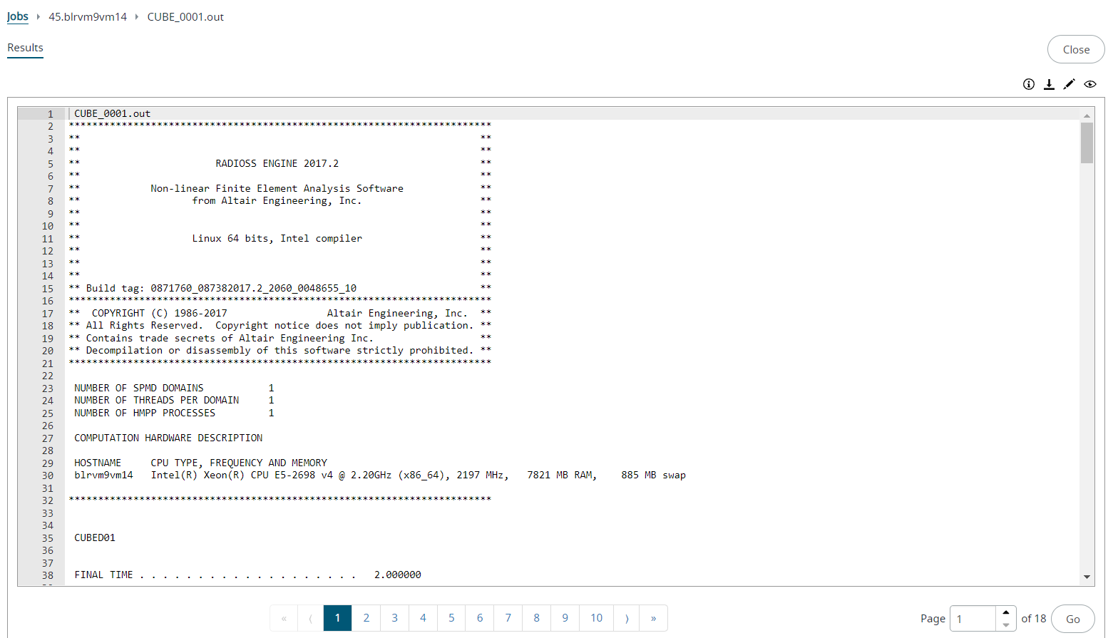

  4. Choose one of the following options:
    • If you want to open the file in the default application, double-click the file.
    • If you want to open the file in the default application, right-click the file and select Open in the context menu.
    • If you want to choose an application and to set a default application to open the file, right-click the file and select Open With.
    Tip: To set a default application to open a file based on the file extension, then select Always Use this check-box.
    The file will be opened in the application:
    Figure: Opened File
