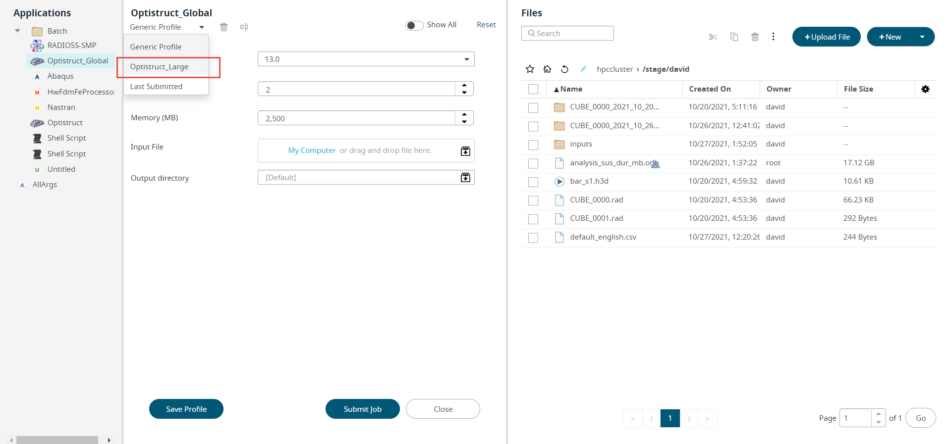

Click Reset at the top right-hand corner of the Job Submission Form to reset the values of application arguments.
Profiles are displayed in a drop-down list just below the application. First time when you select an application, Generic Profile is selected and subsequent time Last Submitted profile is selected.

The saved profile will be displayed in the drop-down list.
Figure: Saved Profile
