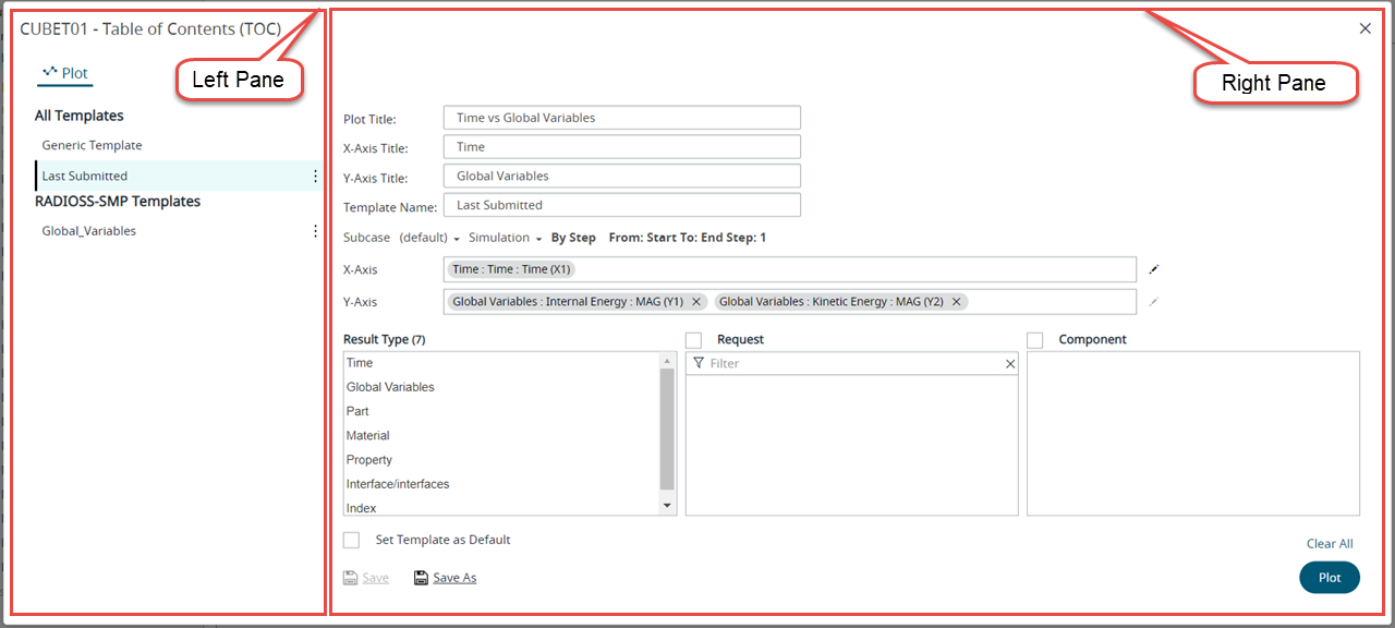

The following panes are displayed:
Figure: Table of Contents (TOC)
  • Left pane displays All Templates and the Solver specific Templates. First time, when you plot a result file, Generic Template is selected and is the only template available in the Templates list. The subsequent time Last Submitted template is selected. The Last Submitted template is created with the result of visualizing the plot file of a job. When you visualize a plot using Generic Template, the Last Submitted template is updated and displayed in the Template drop down list on the plot viewer pane.
  • Right pane displays template details for a plot file. You may create and modify the plot parameters.
    If you wish to view multiple plot result files to the same result type parameters, streamline the view plot result by creating a template. The result parameters is pre-populated in the template.
