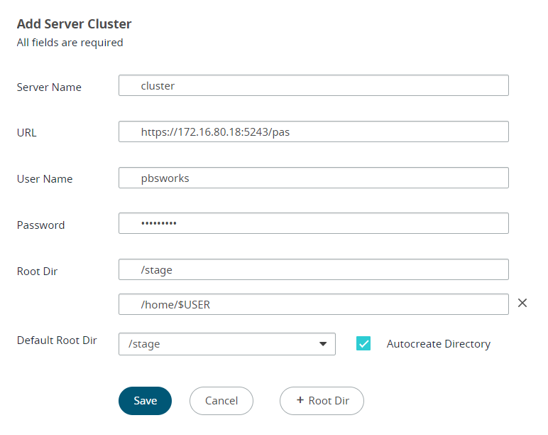

  2. For Server Name, enter a short name describing the cluster.
  3. For URL, enter the URL for connecting to the Workload Manager.
    The URL is in the format https://<hostname>:5243/pas where <hostname> is the hostname of the machine where the PAS Server is installed.
    Note: It is recommended to add a server cluster using the hostname of the PAS Server rather than the IP address. This prevents connectivity issues from arising when an IP address is changed (DHCP, etc.).
  4. For User Name and Password, enter your login credentials.
    The user account and password must be available on the PAS Server.
  5. For Root Dir, enter the pathname where user job input and result files are stored.
    Ex: /home, /users, /stage, /stage/$USER, /home/$USER/project, C:/stage, C:/Users, C:/%HOMEPATH%, C:/%HOMEPATH%/project
    Note: Add parent directory of all Users home during server registration to make home button work.

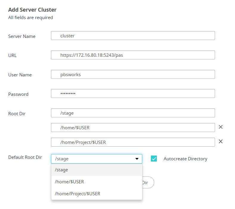

  6. Click if you want to add another Root Dir and enter the pathname.
    Figure: Multiple Root Directory Entry
  7. Select the default root directory to be displayed from the Default Root Dir drop-down menu.
    Figure: Default Root Directory
  8. Optional: Click Autocreate Directory checkbox if you do not want the root directory to be created.
    Tip: By default, auto create directory option is set to true to create the root directory specified if it is not available in PAS.
  9. Click Save.

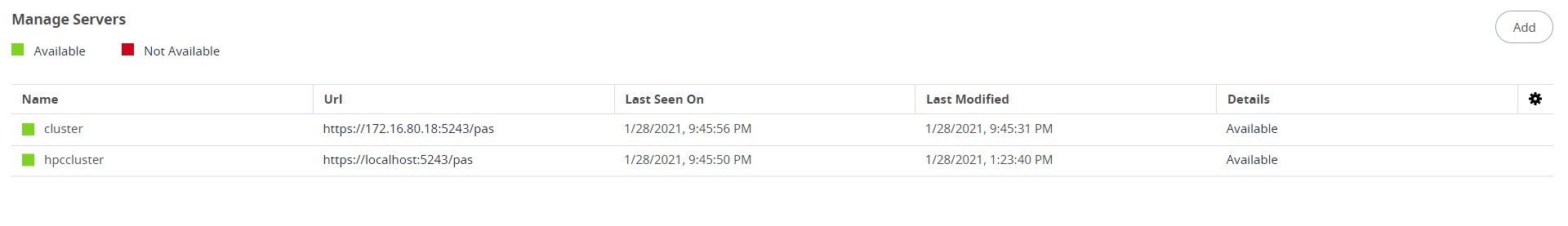

    A list of server clusters that have been added is displayed.
    Figure: Server Clusters List

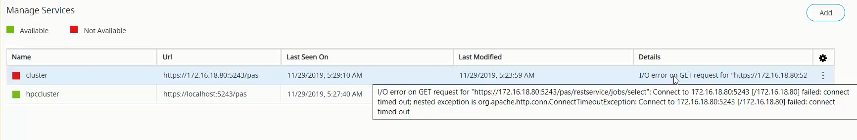

    The green color next to the server cluster indicates that it is available to use. The red color indicates that the server is not available.
    The Details column provides the reason when a server cluster is not available. Mouse hover the Details column of a server cluster to view the error message.
    Figure: Server Cluster Details
