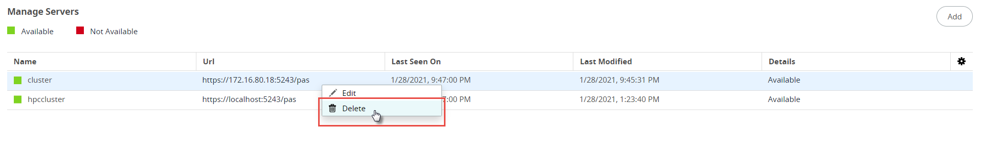

Note: Only a user that has been assigned a Manager role can delete a server cluster.
Click .
A list of server clusters that have been previously added is displayed.
Figure: Manage Servers
Right-click the cluster that you want to remove.
Click Delete from the context menu.
Figure: Server Cluster Delete
Click Yes.
The files and jobs from this cluster will no longer be accessible.
