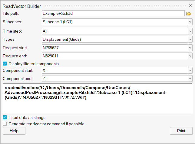

ReadVector Builder
The ReadVector Builder utility helps you create the syntax that reads in the specified CAE data.
To invoke this utility, type readvectorbuilder in the command
window.

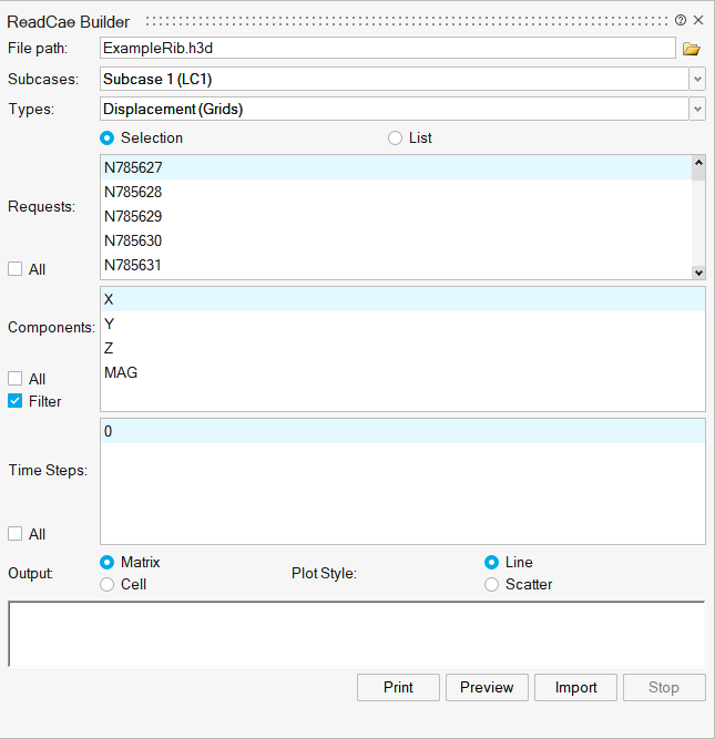

CAE Reader
readvectorbuilder
that not only prints the command that imports the data, but also imports CAE data
with 2D and 3D plots.
