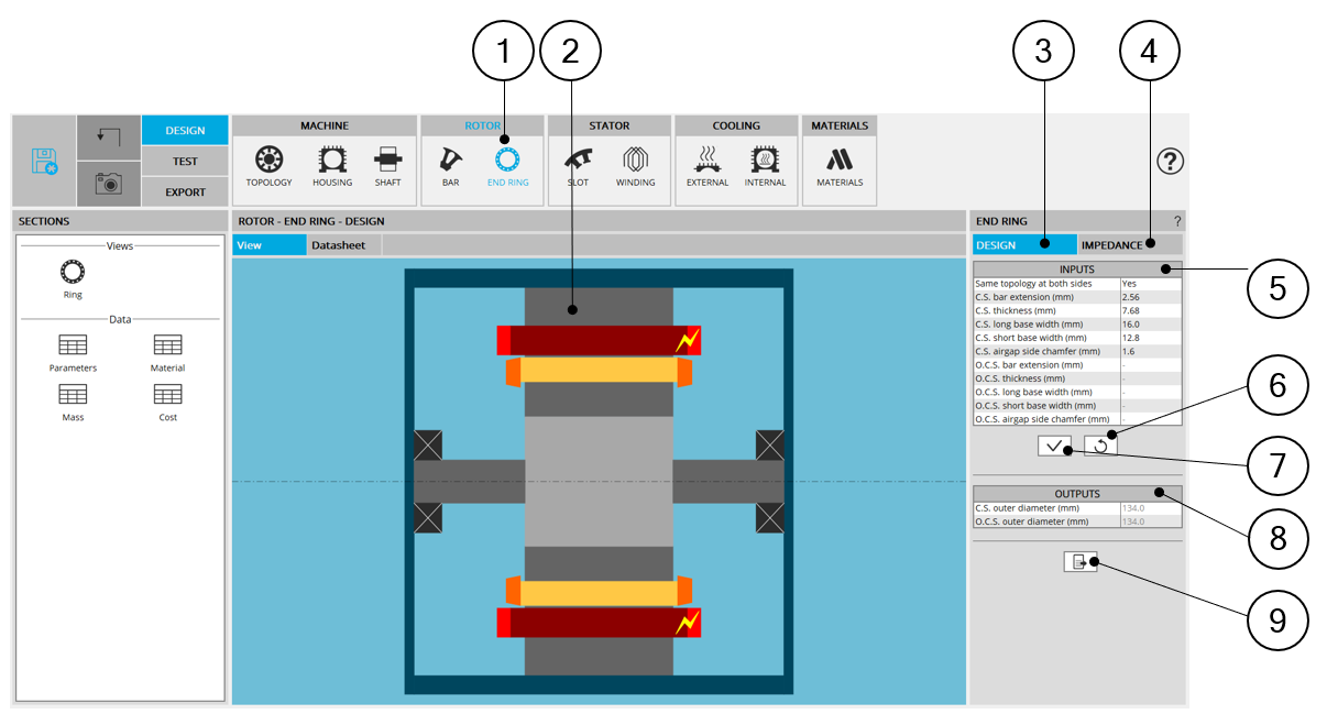

| END RING – DESIGN - design area | |
| 1 | Selection of the ROTOR subset: END RING panel (Click on the icon END RING) |
| 2 | Visualization of the axial view of the machine |
| 3 |
DESIGN tab indicates the tools to define the end ring topology and parameter values Note: By default, DESIGN tab is selected
| 4 | IMPEDANCE tab indicates the tools to define the end ring impedance and check the impedances obtained for various slips, frequencies and temperatures. |
| 5 | End ring inputs to be defined |
| 6 | Buttons to restore default input values. See “Part Factory” application for more information. |
| 6 | Buttons to apply inputs (Pressing the “enter key” twice applies inputs too). |
| 7 | End ring outputs (read only) |
| 8 | Icon to export end ring data into *.txt or *.xls files. |
