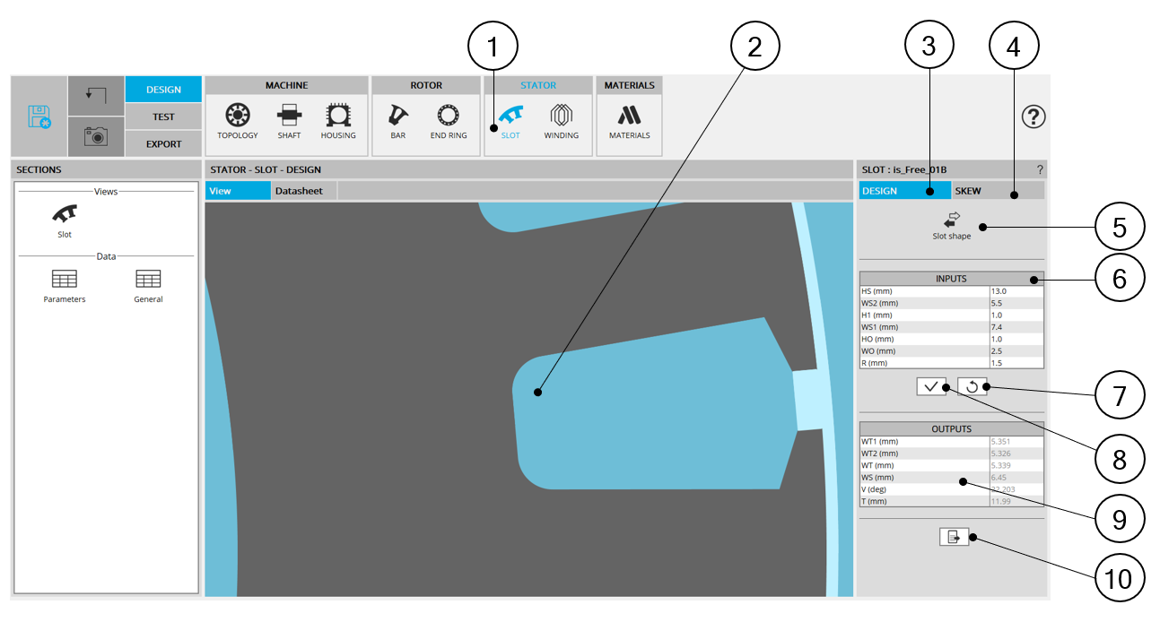

| SLOT – DESIGN - design area | |
| 1 | Selection of the STATOR subset: SLOT panel (Click on the icon SLOT) |
| 2 | Visualization of the motor radial view with slot topology and dimensions. |
| 3 | DESIGN tab indicates the tools to define the slot topology and parameter
values Note: By default, DESIGN tab is
selected
| 4 | SKEW tab indicates the tools to define the slot skew angle |
| 5 | "Slot shape" button allows access to the slot libraries which changes
the slot topology. See additional information below. |
| 6 | User input parameter fields to enter the values. |
| 7 | Button to restore default input values. |
| 8 | Button to apply inputs. Pressing the “enter key” twice applies inputs too. |
| 9 | Output parameters (read only data) to complete the description of the topology. |
| 10 | Icon to export slot data into *.txt or *.xls files. |
