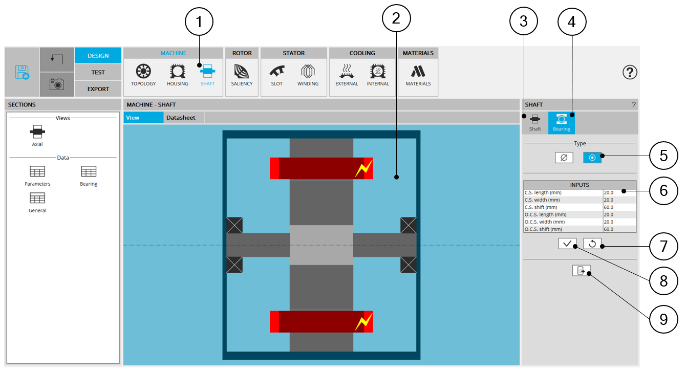

| SHAFT – Bearing - Design area | |
| 1 | Selection of the MACHINE subset: SHAFT panel (Click on the icon SHAFT) |
| 2 | Visualization of the motor axial view to visualize the shaft topology with bearings |
| 3 | Shaft section to define the shaft parameters |
| 4 | When there is a shaft, the section of Bearing is unlocked |
| 5 | Choice of the shaft-Bearing type. Two types are available:
| 6 | Shaft-Bearing input data to be defined |
| 7 | Button to restore default input values |
| 8 | Button to Apply inputs. Pressing the enter key twice applies inputs too. |
| 9 | Icon to export shaft data into *.txt or *.xlsx files. |

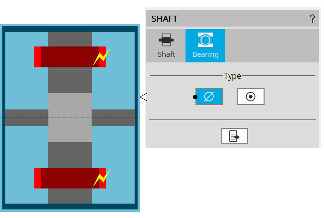

2. Shaft-Bearing type and characteristics
Two types of shaft can be selected:
- None: There is no bearing in the rotor design = No dimension to declare.
- With bearings: Shaft-Bearings are represented and considered in the rotor design.

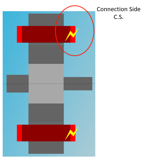

| Shaft-Bearing type: None | Shaft-Bearing type: With bearings |
| Dimensions are illustrated with arrows | Connection side (C.S.) is identified by yellow lightning. |

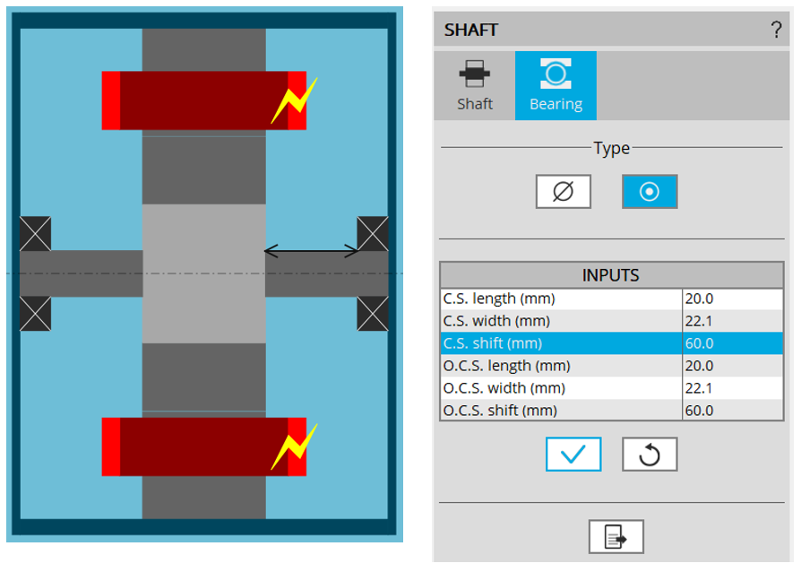

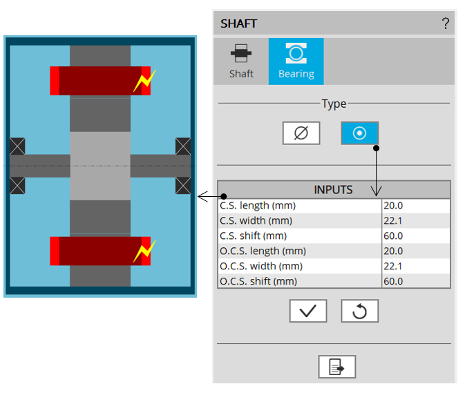

3. Shaft-Bearing input parameters
| Label | Tooltip, note, formula |
| C.S. length | Connection side bearing length. |
| C.S. width | Connection side bearing width. |
| C.S. shift | Connection side bearing shift. |
| O.C.S. length | Opposite Connection side bearing length. |
| O.C.S. width | Opposite Connection side bearing width. |
| O.C.S. shift | Opposite Connection side bearing shift. |

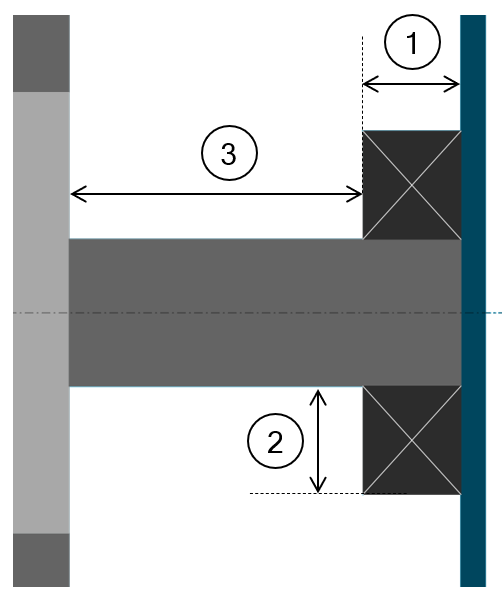

| Solenoid shape cooling circuit – With rectangular tubes - Inputs | |
| 1 | Bearing length |
| 2 | Bearing width |
| 3 | Bearing shift |
