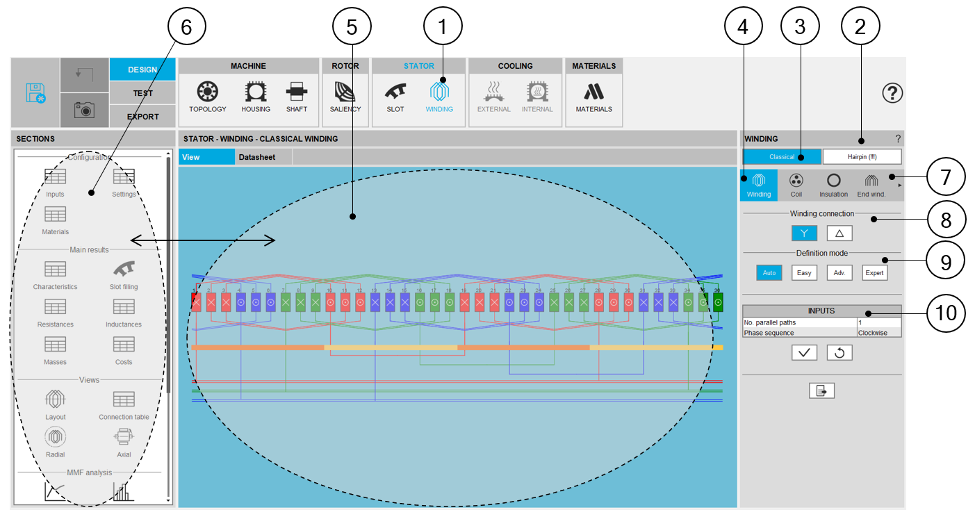

For both types of winding, whether classical or hairpin, the home page characteristics are the same. The following picture illustrates the main areas of the home page which is displayed for the classical winding.
| WINDING design area – Classical winding - Overview | |
| 1 | Selection of the STATOR subset: WINDING panel (Click on the icon WINDING) |
| 2 | All the required user inputs to define the winding are available in the “WINDING” panel (right part). |
| 3 | Selection of the classical winding design (Highlighted in blue) |
| 4 | Winding settings allow describing the winding architecture |
| 5 | Once a winding is defined, the corresponding results are automatically
displayed in the form of a winding report. Visualization of the winding
characteristics (inputs, settings, materials, etc) are
possible .Scrollbars allow browsing the whole document rapidly and giving an overview of all the results. Using scrollbars, complete data can be accessed and visualized. |
| 6 | Shortcuts for displaying the corresponding section of the winding report. |
| 7 | A section scrolling bar allows choosing the section in which user inputs
are defined. Scrolling selection bar where Winding architecture, Coil, Insulation, End-winding, X-Factor and Potting sections can be selected |
| 8 | Choice of the winding connection: Y (Wye) or D (Delta) |
| 9 | Four modes of winding allow to define and build the winding architecture . |
| Auto | Automatic mode, used as default. |
| Easy | Easy mode, to choose solution among a list of choices. |
| Adv. | Advanced mode, to allow the user to define any specific input parameters. |
| Expert | Expert mode, to set the connection table. |
| 10 | User input parameter fields to enter the values according to the considered mode. |

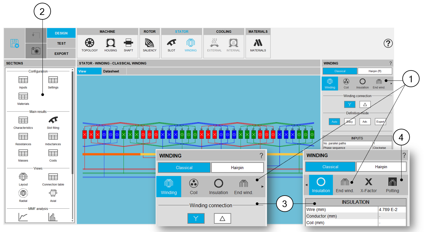

| Scrolling selection bar – Winding environment | |
| 1 | Scrolling selection bar where Winding, Coil, Insulation, End-winding, X-Factor and Potting sections can be selected |
| 2 | Section data can be reached thanks to shortcuts |
| 3 | Arrow allows scrolling the bar to reach other sections (on the right or the left) when needed |
| 4 | The bar slides on the right to allow reaching Potting section |
