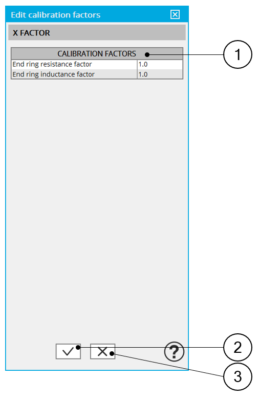

X-Factors
The calibration factors (X-factors) are user coefficients to tune the inter bar end ring resistances and inductances.
| END RING - IMPEDANCE area – X-factor window | |
| 1 | Calibration factors to be defined |
| 2 | Button to validate the calibration factor of the table and back to the Motor Factory – BAR – IMPEDANCE context |
| 3 | Button to cancel the calibration factor window and back to the Motor Factory – BAR – IMPEDANCE context |
