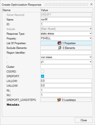

Add a user-defined response that returns maximum von mises stress of elements
under PSHELL_1 property.
Note: Responses can be defined in HyperMesh prior to realizing the connection.The following responses are extracted by default.
- Mass
- Volume
- Maximum Displacement for each linear static load case
- First Mode if normal modes analysis is included
In the Optimize ribbon,
Targets group, click the
Responses tool.
The Create Optimization Response dialog opens.
- In the Create Optimization Response dialog, enter vomM for Name.
- For Response Type, select static stress.
- For List Of Properties, select the value.

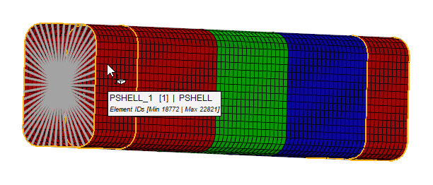

In the model, select PSHELL_1 and click
to confirm your selection.
Figure 2. - Click Close.

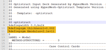

From the menu bar, click File > Export > Solver Deck to export beam.fem to the working
directory.
Note: The file may be opened in a text editor of choice to view the parameters.

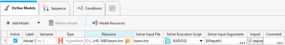

Add the OptiStruct model by dragging-and-dropping
the beam.fem file from the Directory into the work
area.
Figure 5. -
