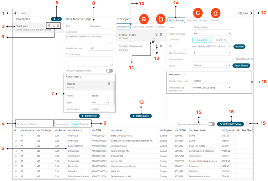

The Data Table Editor layout is displayed as below, wherein in this example, there are joined data sources:
Property
1
Back
Exit the Data Table Editor view and go to the Open Workbook in Design Mode view.
2
Data Table
List of data tables. Can be rearranged.
3
Toolbar
After the data is successfully retrieved, three options on the Data Table Editor layout allows:
·    Making a duplicate of the data table
·    Publishing the data table template
·    Deleting the data table
4
Search Columns
Allows searching of columns on the Data Sources Preview.
5
Data Preview
Executes the queries to return and display preview of the data table you are creating.
6
Add Data Table or Select Data Template
Add data table or select a data table template.
7
Data Table Parameters
Add or manage data table parameters.
8
Data Table Settings
Definition of the name of the selected data table, description, and the auto refresh period (in seconds). Also allows the retrieval of external aggregates and set custom message to be displayed upon unsuccessful data connection.
9
Group and Sort Columns
When the Column Order is set to Sorted, the columns are grouped by type (Text, Date/Time, then Numeric) and sorted alphabetically.
10
Data Sources
One or more data sources that can be connected to directly, with data retrieved on the fly as it is required. Can be rearranged.
11
Join/Union All Definition
Allows definition of a join or union all of multiple data sources.
12
Duplicate Data Source
Allows creating a duplicate data source
13
Add Data Source
Allows adding data sources from the available data connectors.
14
Data Source Settings
Displays the data source settings and allows for limiting the amount of data to be returned.
15
Preview Selected Data Source
Preview the selected data source on the Data Preview panel.
16
Refresh Preview
Refresh the data sources preview.
17
Save Data Table
Save the data table definition and go to the Open Workbook in Design Mode view.
18
Row Limits Settings
Allows setting of the row limit of data sources.
19
Collapse Data Preview
Collapse the Data Preview pane. Click  to expand the Data Preview pane.

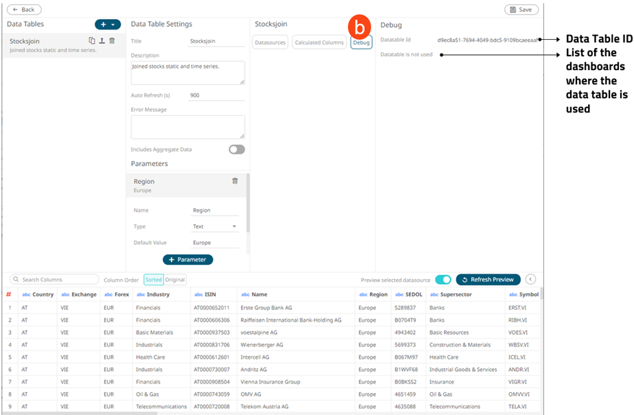

Clicking Debug  displays the Debug pane.
Property
Datatable Id
Id of the data table. Can be used for parsing of server logs.
Datatable is used on dashboard(s)
List of dashboards where the data table is used. If a data table is not used, it can be deleted.

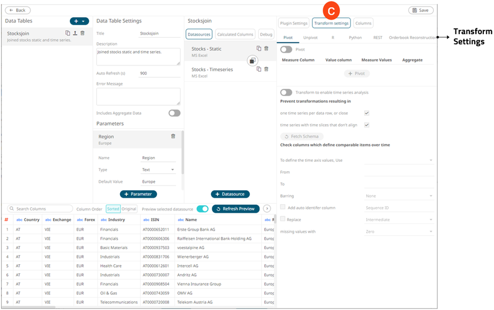

Clicking Transform Settings    displays the Transform Settings pane.
Property
Transform Settings
Allows you to perform the following:
·         pivoting or unpivoting retrieved data
·         transforming data to enable time series analysis including interpolation
·         running an R or Python script for data transformation
·         lists of orders to be reconstructed into an Order Book and conflated for output display

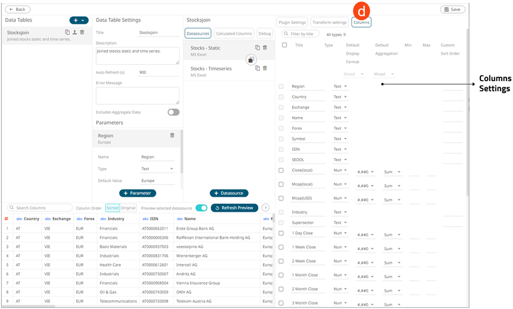

Clicking Columns   displays the Columns Settings pane.
Property
Columns Settings
·         view the column data type
·         rename the column names
·         select the numeric or Date/Time format
·         select the numeric default aggregation
·         define the Min and Max range of numeric columns
·         define custom sort order
