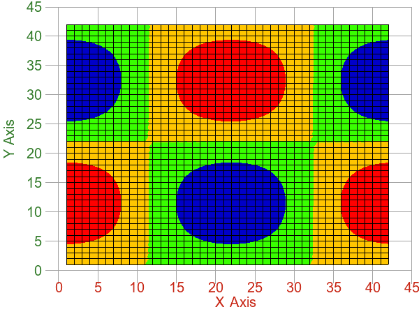

cla;
x=[0:0.15:2*pi];
y=x;
z=sin(x')*cos(y);
contour(z, 4);
Figure 1. Contour plot with four color levels
