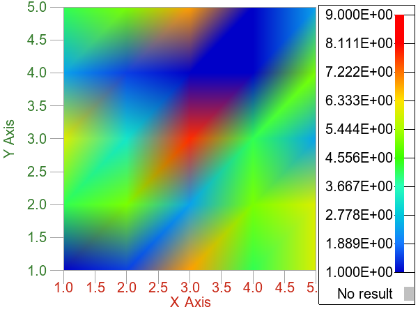

cla;
x = 1:5;
y = 1:5;
z = [1 2 8 5 7; 5 6 3 6 7; 7 4 9 5 3; 3 2 1 1 6; 5 6 8 1 3];
ph = pcolor(x, y, z);
set(gca,'contourtype','blended');
Figure 2. pcolor plot - blended colorsComments
