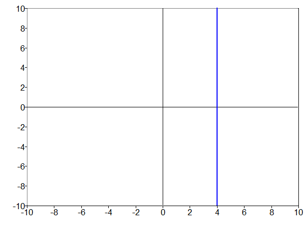

Examples
clf;
h = xline(4);

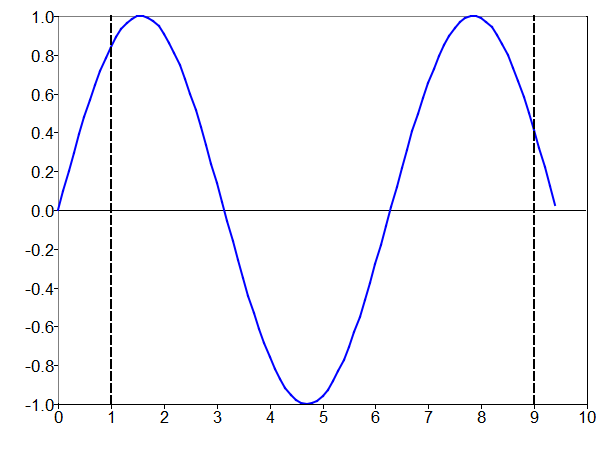

Figure 1. Vertical line at x = 4clf;
x=[0:0.1:3*pi];
plot(x, sin(x));
h = xline([1;9],'color','k','linestyle','--');
Figure 2. Create 2 lines and set propertiesComments
If there is no axis, one is created first. If x is an Mx1 matrix, then M vertical lines are created.
If an axis exists, lines are added to it without clearing existing lines.
