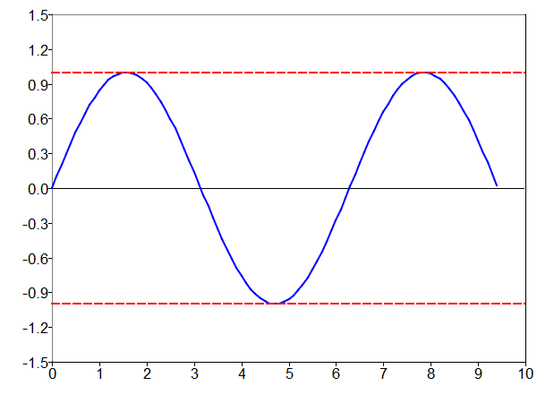

Figure 1. Horizontal line at y = 2clf;
x=[0:0.1:3*pi];
plot(x, sin(x));
h = yline([-1;1],'color','r','linestyle','--');
ylim([-1.5 1.5])
Figure 2. Create 2 lines and set propertiesComments
If there is no axis, one is created first. If y is an Mx1 matrix, then M horizontal lines are created.
If an axis exists, lines are added to it without clearing existing lines.
