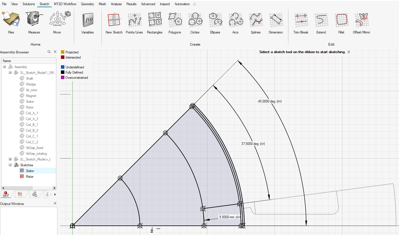

This tutorial shows how to use SimLab to design and run electromagnetic analysis with Flux solver for electric motors. The studied device, a brushless DC motor with surface permanent magnet, includes the following elements:
  • a fixed part (stator) including yoke, slots, and windings
  • an air gap
  • a movable part (rotor) with surfaced magnets

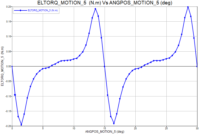

  • Analysis 1: Computation of the cogging torque

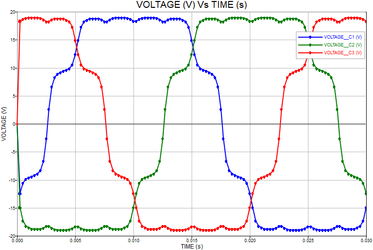

  • Analysis 2: Back Electromotive Force

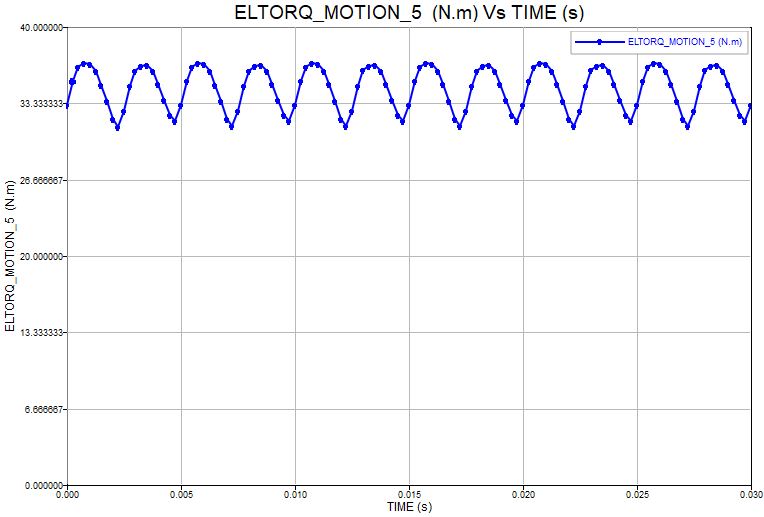

  • Analysis 3: Constant speed
