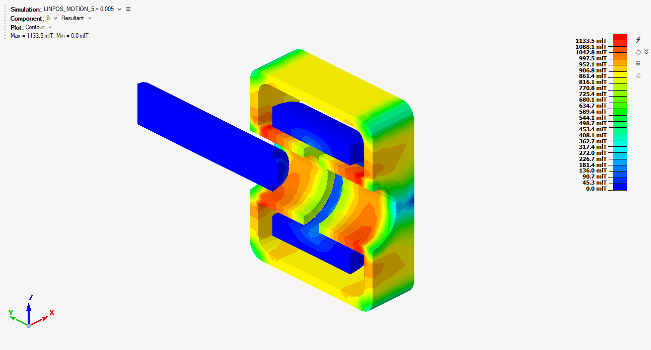

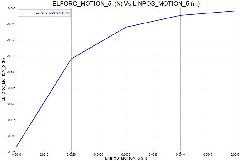

Analysis 1: Computation of the electromagnetic force
This a 3D magneto static solution.
Visualisation of magnetic flux density, magnetic field and force curve depending on the mobile part position.
